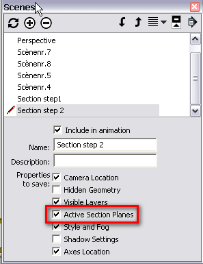

                  Hello Gaieus, I've started again from scratch and discovered the free style drawing which suited me when drawing crescent shaped lime walls. However, hours of studying the 'animation of section cuts' have not yielded any working result. It's difficult to see what is ticked in the training videos and the written section does not offer a clear, step by step guide either. In the sample below I have attempted to activate the section cuts, but nothing happens at all. Where am I going wrong ? Best regards, Willem44
                  The third and the fourth tab (section cuts) don't work.
                    Hi Willem,
                    In the scenes dialog, you need to check the "Active section planes" box in order that the section cuts update when you change scenes (don't forget to update the scenes, too).
                    I made two new scenes at the end of the "row", see how it works now. The steps should be:
                    1. Add a section plane in scene 1 (right click and make sure it is the active cut)
                    2. update the scene
                    3. add a new section cut and add a new scene (again check if that is the active cut)
                    4. turn of section plane visibility and update your style

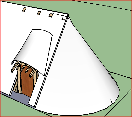

                              Having started anew, I managed to complete the entire wooden framework of the bronze age farmhouse. I've got stuck in the final stage: putting the thatch on the roof. The flat parts are easy enough: a rectangle extruded to be painted with an imported photo sample of a thatched roof. But the conical bits above the doors and at the far end defy my best attempts. Please have a look at the model so far and the attached photograph of the real farmhouse. How shall I go about completing it ? Can I still animate the pillars first rising from the ground, then see the roof being added, perhaps horizontally from left to right and finally see the completed model blend into a live video scene ? Best regards,
                              Willem.

                              • TIGT Online
                                Willem
                                A few tips...
                                Make your model in 'real size' - you seem to be making it too small πŸ˜• - it's easier to work in actual units.
                                Group parts of your model as you work to avoid geometry 'sticking together' you can then move/adjust more easily - you can always explode groups together later on if you want to join thing together.
                                Use a Style that shows edges - try to model without seeing them is difficult - you can always change the Style later.
                                To make complex 'organic' shapes you ought to think about a plugin - the quick half-baked example below was made with my EEbyRails tool - but to do that you'd need to separate out the 'profiles' and 'rails' as 'curves' [weld script] and the get it to make the 'meshes' to suit - there's also Fredo's CurviLoft tool. You CAN make organic shapes if you have edges 'shown' and you then hand-stitch edges to make triangular facets, adding one to another to make 'organic' surfaces - find some 'car' tutorials - they show this method and your roof shape is actually quite like a car or plane if you think about it as a shape rather than what it 'is'...Capture.PNG
                                  What TIG says is ver important. Always model to real scale and separate your geometry by grouping parts together (or - when there are more instances of the same object, use components).
                                  Texturing should not be an issue. The part over the entrance can easily be textured with a projected photo of the thatch material and also the conical end is not that hard. We can get back to it when you finished those two parts and already have some good thatch material.
