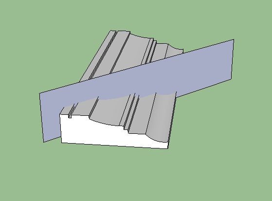

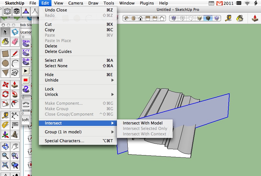

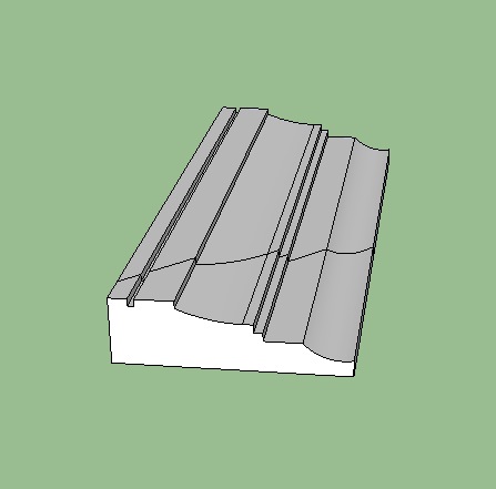

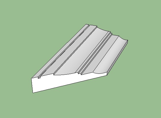

          The best way to mitre complicated geometry is with the intersect command. First create a rectangle that will be able to fully "slice" the moulding, then rotate it 45 degrees (Using the rotate or move tool). Once again, make sure the rectangle goes right through the moulding. Highlight the moulding, and go the "edit/intersect menu" and click "intersect with model".( a note here: if you were to select the rectangle and tell it to intersect, it would form a negative moulding profile in the rectangle) Delete the rectangle and erase the part of the moulding you don't want. Attached are some jpegs visualizing the process.
