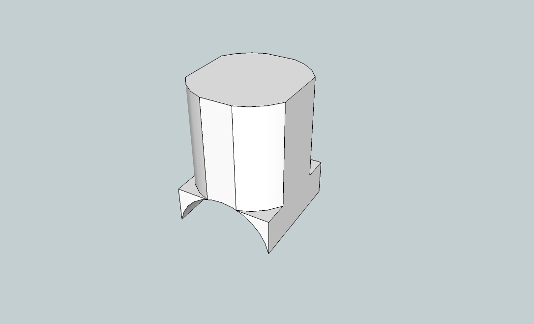

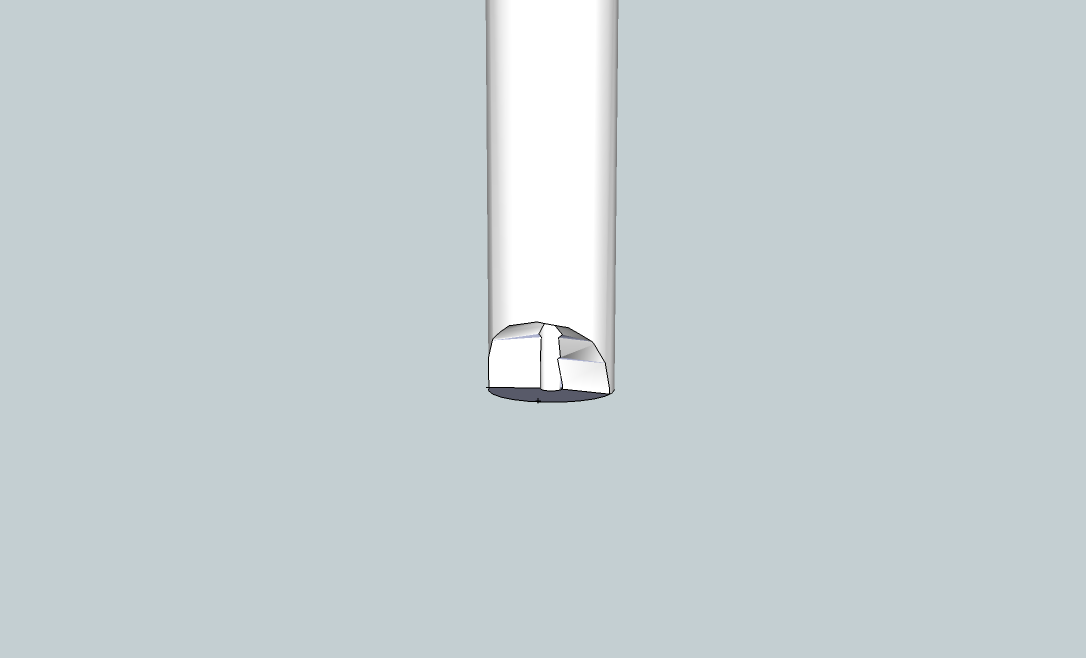

            Alright, I've successfully designed a top tube that starts as a rectangle, then blends to an oval. So that's taken care of.
            Now I'm having trouble with the tube miters. All I need to do is put a half circle on the bottom of the tube, and push it, but of course, I can't on a curved surface, and the push/pull plugin I got (sorry, I don't remember the name of the author) is just messy, and inaccurate for something that needs a smooth miter.
            I tried making a square tube, and pushing the half circle out, then taking the four corners off to make a circle, but the push/pull limits the offset to the intersection of the circle. (I've included a screenshot of both the miter attempt with the push/pull on curved surfaces, and the square with circle idea)
            Thanks folks, I've been trying for a long time now with no success, so I'm hoping someone has done this.
            My attempt at the square first technique
            The aftereffect of the lines on curved surfaces plugin mixed with the push/pull on curved surfaces plugin.
              Is this what you mean?
              Tube Mitre.skp
                [attachment=0:2dothqcn]<!-- ia0 -->Tube Mitre.skp<!-- ia0 -->[/attachment:2dothqcn]
                AAARRRRGGGGHHHHH!!!!!!!!! How could it be so EASY???!!!!!
                That is frustrating to work on it for HOURS, not getting anywhere, then do it in 45 seconds. 😢
                Good news is, I know how to do it now. And thats all that matters. Thank you rclub24 for helping me stay sane.
