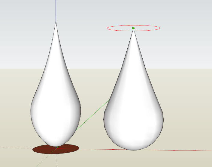

          draw half of it from a side view then follow me around a circle to make it full
          โ€œThere are three classes of people: those who see. Those who see when they are shown. Those who do not see.โ€
            See attached file for example
            See this post , http://forums.sketchucation.com/viewtopic.php?f=323&t=13563&hilit=plugin , for plugin
            [EDIT] Both Rocky's and Honolulu's methods are good solutions too ๐Ÿ‘ Sorry guys i had started replying, i'm not trying to confuse the issue ๐Ÿ˜ณ
            Drop Tutorial.skp

              i figured for an apparent newb its always best to try without plugins first. otherwise you'll soon see a new post 'how do i install plugins' then 'why are my toolbars screwed' and still the user won't know the simple native SU tools.

                BTW, the smoove tool does a decsent job on a sphere as well. see second droplet.
