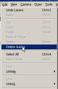

      Good evening,
      Very novice user working with ShetchUp. I am using the program to lay out underground mines in relation to other existing mines. As I lumber along, I ran into a small problem. I have an "x" that I believe is left over from a measurement line that was erased. I am unable to erase it. I have tried the erase tool, tried selecting the object (nothing happens), or covering it with another object and then erasing the object but to no avail. Its as though it is an orphaned piece that is no longer recognized as anything.
      Any suggestions would be greatly appreciated.
      Timothy

          Good afternoon,
          Thank you for the tip,delete guidelines. It took care of my little orphan "x" but did take out a couple of other guidelines. No problem, I just did them over again.
          Thanks again.
          Timothy
          • TIGT Offline
            Delete Guides removes ALL Guide-lines/-points - even when they are inside groups and components !
            However, there are several scripts about that erase only guide-lines or guide-points... and can also limit this action to 'active_entities' or 'selected_entities' - useful if you want to retain some others elsewhere in the model... πŸ˜‰
