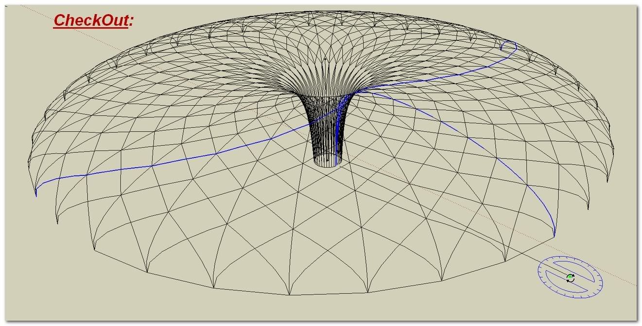

      How to make a structural curvy roof by chang
      http://wpcontent.answers.com/wikipedia/commons/thumb/1/19/British_Museum_Great_Court_roof.jpg/250px-British_Museum_Great_Court_roof.jpg
      As I think this purpose can be for a general interest, I open a special thread into this Tutorial Section to explain my way to achieve this. ☀
      http://i274.photobucket.com/albums/jj245/Spendauballet/SketchUp/Dome001th.jpg
      http://i274.photobucket.com/albums/jj245/Spendauballet/SketchUp/Dome002th.jpg
      http://i274.photobucket.com/albums/jj245/Spendauballet/SketchUp/Dome003th.jpg
      http://i274.photobucket.com/albums/jj245/Spendauballet/SketchUp/Dome004th.jpg

      Native FollowMe tool is overpassed with this kind of 3D curve job. It makes the shape rotating along the path.
      Some other solutions exists.
      I have tried: [url=http://www.sketchucation.com/forums/scf/viewtopic.php?f=180&t=16465:1zfgxzyj]wikii_FollowMe and keep[/url:1zfgxzyj] But in our case, the result does not suit..
      We can also use [url=http://forums.sketchucation.com/viewtopic.php?f=180&t=21658:1zfgxzyj]Kirill _ 2 Faces + Path[/url:1zfgxzyj] following this kind of method: [url=http://forums.sketchucation.com/viewtopic.php?f=180&t=23237&start=0#p198203:1zfgxzyj]Copy Array Along Path tool...have a look.[/url:1zfgxzyj]
      but this exercise is hard for it too.
      The last solution to make our shape follow our curves resides in Extrude along a path from 1001bit tools.
      This one also need to be tamed. For example it absolutely doesn't like to initiate on a vertical line..
