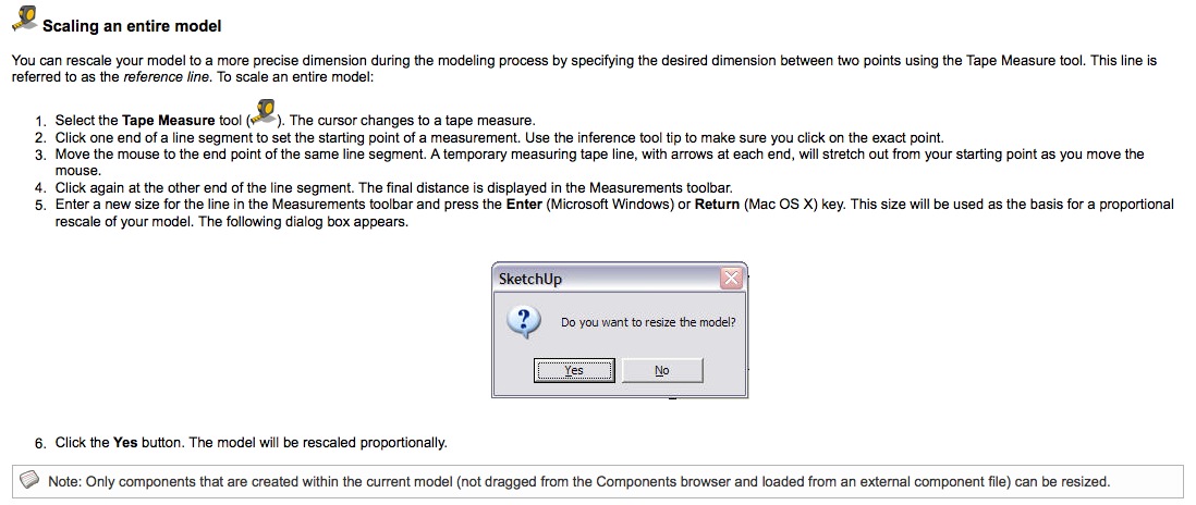

                Here is what google has to say about using the tape measure tool to resize your component.
                In your case if you measure any part of the component and type in half that number it should change your 10' component into a 5' component.
