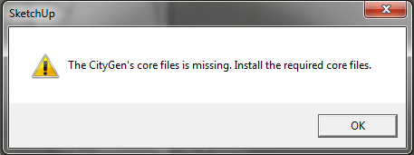

                        Hi I hope this thread isn't totally dead, even though the plugin is no longer supported. I'm trying to get the Street Generator to work and can't get any luck installing. I've been able to get the City Gen extension to appear in the menubar but there's no Street Generator tools available.
                        In my Plugins folder, I've placed the "city_gen.rb" along with the folder named "citygen". In this "citygen" folder, I've added the file "street_gen.rb" and the folder "street_gen" to the Modules folder. As far as I can tell, this is the extent of the install.
                        Some things I'm unclear on... where does the file "city_gen_loader.rb" go? And do the folder names have to match the .rb names exactly (my .rb file is "city_gen.rb" whereas my corresponding folder is just called "citygen", without an underscore).
                        I do get an error message from Rubyscript but it's really long so I can repost it if anyone cares to look. This is the last thing I need to sort out on this project, so I'm dying to figure this out! Thanks in advance.
