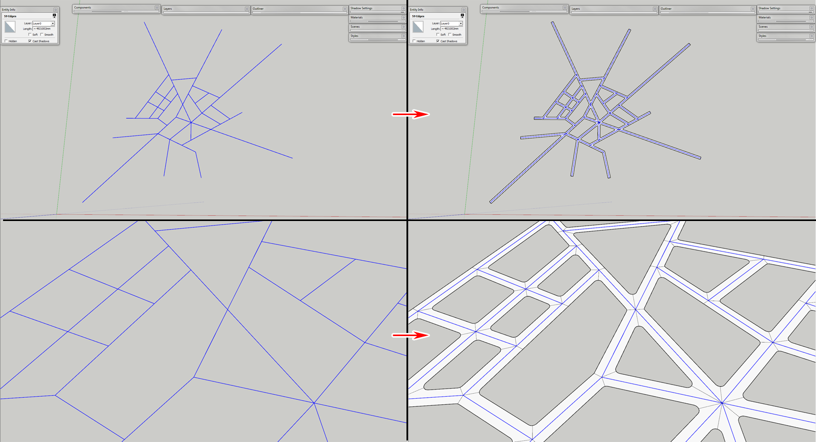

      Street Generator
      Generates streets from a set of centre line edges.

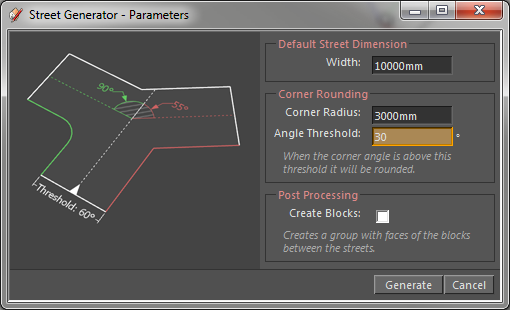

      Current Properties Dialogue

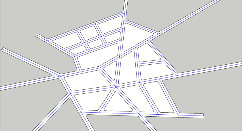

      Version 0.4.0 Adds option to generate faces for the blocks between the streets. (Separate module?)
      Option to generate faces for blocks.

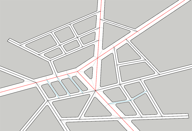

      Preview of 0.5.0a
Variable street width
      The streets can have custom sizes - defined by the material applied to them. The properties are set in the material name. A street manager windows is planned, but not yet complete. Currently the only way to modify the street properties is manually editing the material name.
      Example of material name: CG_Street_Main_W:20000mm
      • CG_Street_Main_W:20000mm - Materials defining streets must start with this.
      • CG_Street_Main_W:20000mm - Name of the Street. Not currently used - will be used later in the Street Manager.
      • CG_Street_Main_W:20000mm - Defines the width of the street.

                                        At the moment, is you set the Minimum Rounding Angle (weird name - this'll get cleaned up when I get a webdialog working with better explanation and illustrations.) to more than 180 degrees there won't be any rounding.
