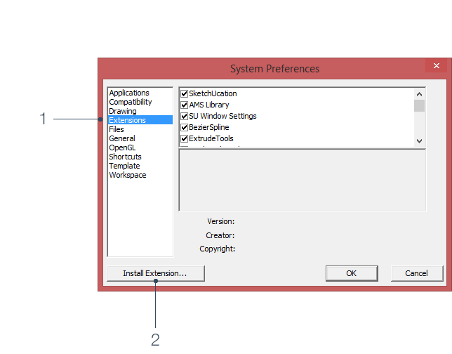

          When you start Sketchup, do you see the menus for the plugins. Do you see the menu Window > LibFredo6 settings.....?

            Yes you mean the window check Fredo6 Plugins for Update?
            • RienkR Offline
              Rienk @fredo6
              • RienkR Offline
                Rienk @fredo6
                @fredo6
                You mean the dialog window "check Fredo6 Plugins for Update?
                I started SketchUp again and It seems to work fine with your plugins.
                Thanks for your reply.
                Rienk
