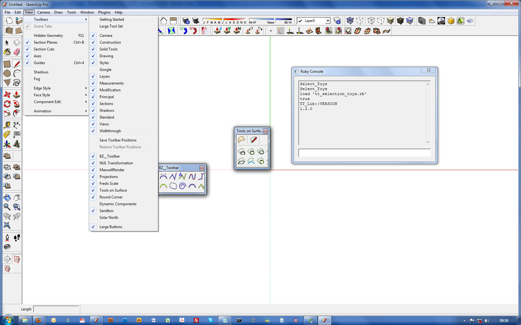

                              • N3TON
                                N3TO
                                @thomthom said:
                                I can make so sense why you would not have a Selection Toys menu item under tools and various Context Menu entries (which depend on what you right-click)
                                I was about to ask if you'd checked the Preferences for Selection Toys, but if you have not menu... I'm really stomped.
                                Can you post a screenshot of your Tools menu?
                                Hello Thomas!
                                It happens with me also! You can see a screenshot here
                                http://www.netcond.net/N3TO/Screenshot_toolsmenu.jpg
                                I see all posts but I can't resolve the trouble.
                                apologies for my bad english...
                                Thanks
                                • thomthomT
                                  thomthom
                                  Check the Tools menu.
                                  Tools -> Selection Toys -> Enable Toolbar
                                  then after you do that - check the menu you showed in the screenshot.
                                  Thomas Thomassen β€” SketchUp Monkey & Coding addict

                                      • brookefoxB
                                        brookefox
                                        It was working in V7, but I can't get Sel Toys working in V8. Feeling stupid for a number of reasons.
                                        My configurtion of Sel Toys:
                                        C:\Program Files (x86)\Google\Google SketchUp 8\Plugins\TT_Lib
                                        C:\Program Files (x86)\Google\Google SketchUp 8\Tools\TT_Select_Toys
                                        After SU8 re-start:
                                        no context picks for Sel Toys
                                        no pick for Sel Toys in Tools menu drop down
                                        ~ Brooke
                                        • thomthomT
                                          thomthom
                                          Don't put plugins in the Tools folder.
                                          There should be
                                          C:\Program Files (x86)\Google\Google SketchUp 8\Plugins\TT_Lib\ - (inside, lots of .rb files)
                                          C:\Program Files (x86)\Google\Google SketchUp 8\Plugins\tt_selection_toys.rb
                                          C:\Program Files (x86)\Google\Google SketchUp 8\Plugins\TT_Select_Toys\
                                          • brookefoxB
                                            brookefox
                                            OK. Thank you. I thought that since it is accessed by the tools menu..., but thinking is not my strong suite.
                                            You must enable it from Tools->Selection Toys->Enable Toolbar before it appears under View->Toolbars->Selection Toys.
                                            While the install didn't seem that clear to me, I didn't notice many install problems in the thread, so likely I am being thick. Perhaps because I assumed it was different than the norm when it is not. (Is the download count related to this, only 141 for such a useful tool? Or is that count only since the last update or somehow not reliable?)
                                            Thanks, again.
                                            ~ Brooke
