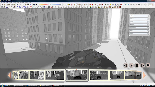

      To really be able to use SketchUp for animation purposes - in an intuitive way comparable to the ease of modelling - would be a wonderful enhancement to this software. I spent a great deal of thought on how a rough shape of such a plugin's interface could look like, what the workflow should be like and what important features should be implemented. I would very much like to hear your opinion.
      the following description is long and very detailed. so only read it, if you got a lot of time and patience 😉
      This new plug-in is a key-frame based animation tool for SketchUp, that enables you to animate groups and components, as well as all camera settings to create advanced presentations of your model.
      The Interface
      The main interface consists of a reel at the bottom of the screen, that contains small images representing the various key-frames. If you double click a frame, it becomes active, therefore rotating the reel until it is centred in the observation frame. At the same time your stage in SketchUp updates to this specific key-frame. You can flick through the frames by spinning the reel with your mouse or clicking the arrows on either side of it.
      http://img87.imageshack.us/img87/664/animationgui2jl5.jpg
      (the bat mobile is not my creation - downloaded it from google warehouse)
      high-res image to be found here
      Key-frames define the position of cameras and geometry at certain points, interpolating all the frames in between. You can view these intermediate frames by moving the small slider at the top of the observation frame. If you want to change the position of an object at a certain point, you can insert a new key-frame.
      Key-frames are scenes and are therefore listed in SketchUp's scene manager window. In order to save all information necessary an animation tag is added to scene information. You can decide if a scene is showing up as a tab at the top of the stage. You will probably have only views showing up there that you need for modelling, views that are not part of the animation as a key-frame (something you can choose in the scene manager as well).

            thanks guys for the comments.
            just to be perfectly clear: this is only a dream (thats why it was posted in the wish list). I have no knowledge of coding whatsoever. but I couldn't help thinking about such a plugin for a long time and simply had to share my thoughts.
            and you never know. perhaps someone will read this at google and will be inspired... 😄
            I have allways been living in dreams and like to discuss them in full earnest. and sometimes - especially with ruby arround 😉 - these dreams become true
            if you have any suggestion of what could be added or changed, I would love to hear them.
