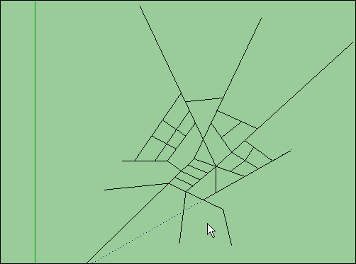

                              ThomThom, you give a skp file CityBuilder_stree2.skp as a sample to test and the road centre lines are coloured which I presume is for the road categories. Where, how or what program generated this file? ie how are these lines coloured in and categorised to produce the variable road widths that your sample does?
