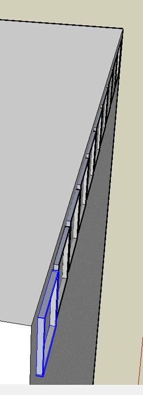

      Hi Jean !
      Thank you for the fast reply !
      I want all frames on ONE plane and found out that
      if you pull and the colored line comes up and you
      press shift it lets you lock to that direction !
      Peter

    • Multi copy problem....
      Hi I´m new to this forum and have I question !
      I couldnt find any related posts
      but I have a problem with multi copy of recessed components.
      When I drag and paste I dont get them " ON SURFACE" they are all going off !
      can anybody help me ! Can I tell the program to multi copy with same depth on wall.
      When I drag frm component library it always snaps into same place (depth)
      Peter
