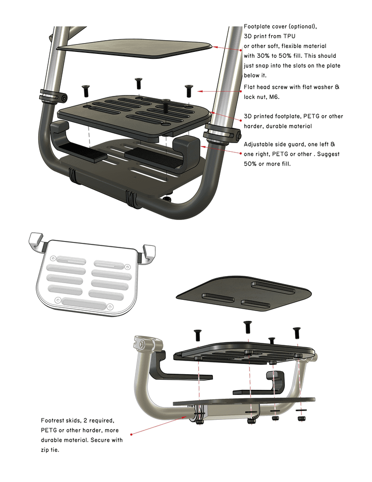

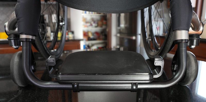

      A few practical models for 3D printing shown in LayOut.

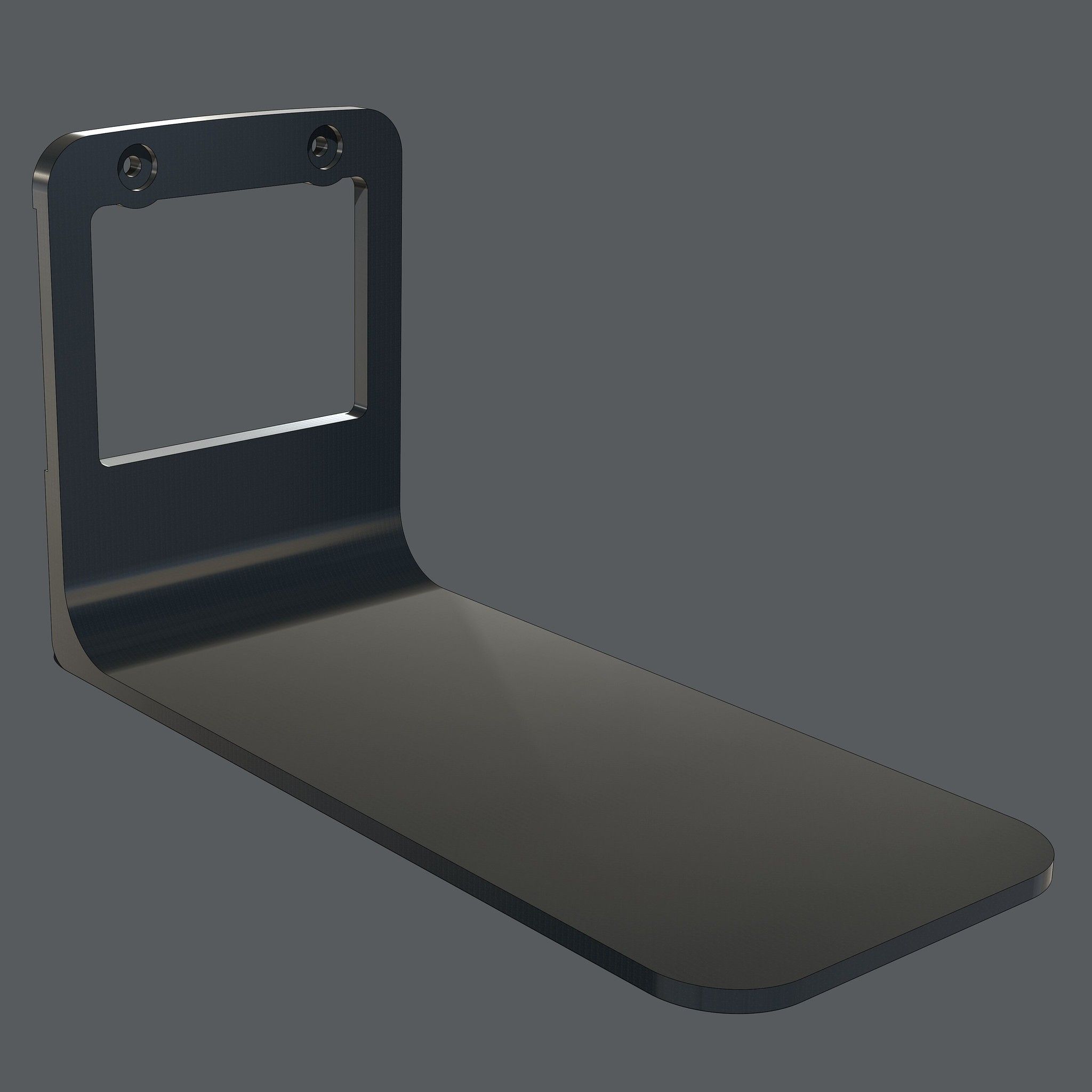

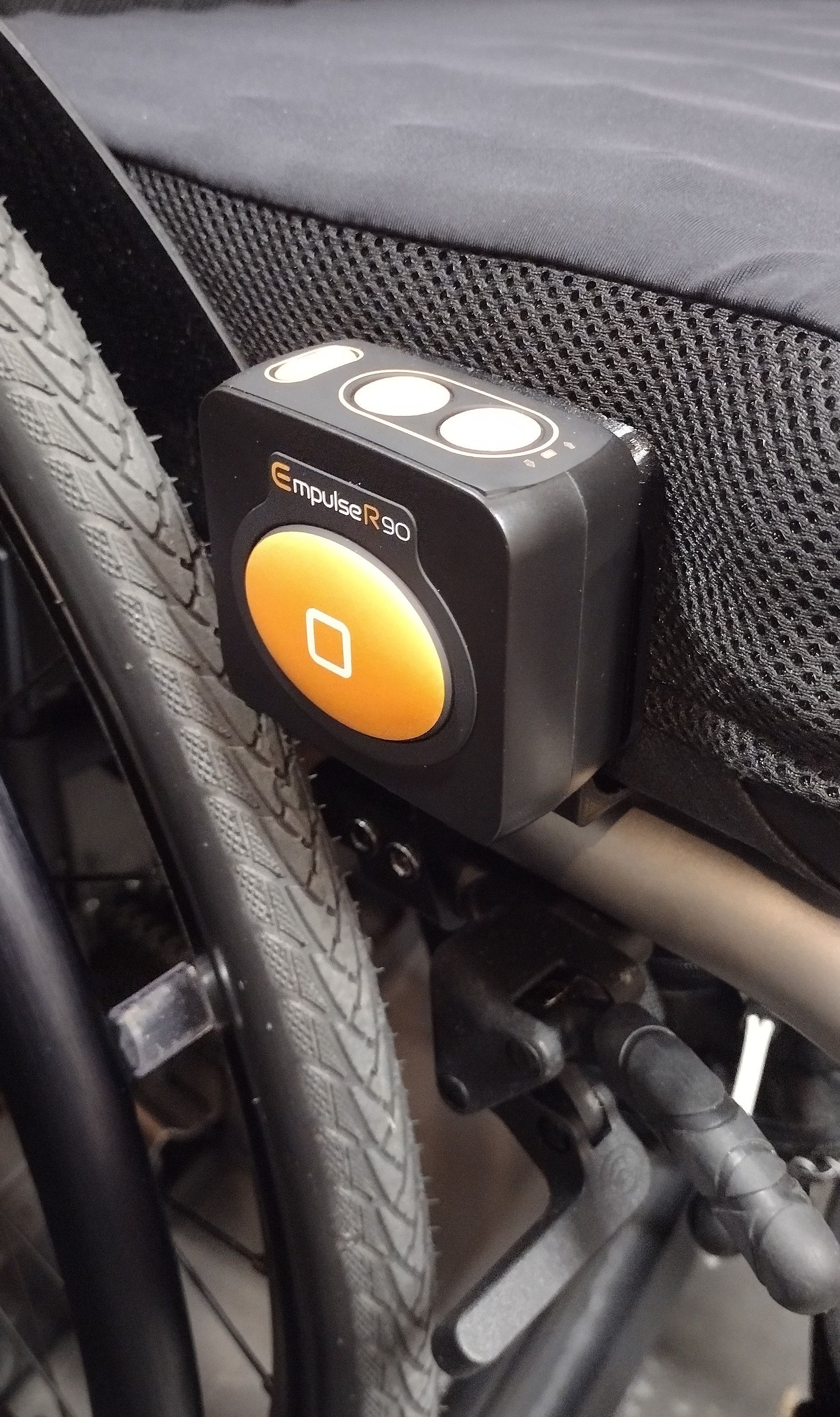

      A bracket to mount a small control box.
      Secures with velcro between seat and seat cushion. Unlike the OEM mount, no tools required to install or remove it.

        Great design. 3D printing empowers people to make bespoke solutions to everyday issues!
