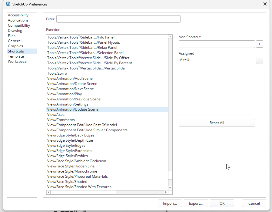

          I don't recall ever setting a keyboard shortcut for that but it appears I have one. Maybe it's an OEM default?

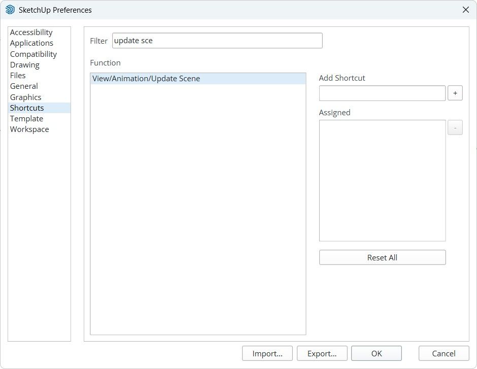

            @dave-r
            I've nothing there. Never set one either and my Alt+U is not assigned
            • Dave RD
              @rich-o-brien I'm old and I haven't had enough coffee this morning to wake up my rememberer. That's my story. πŸ˜„
