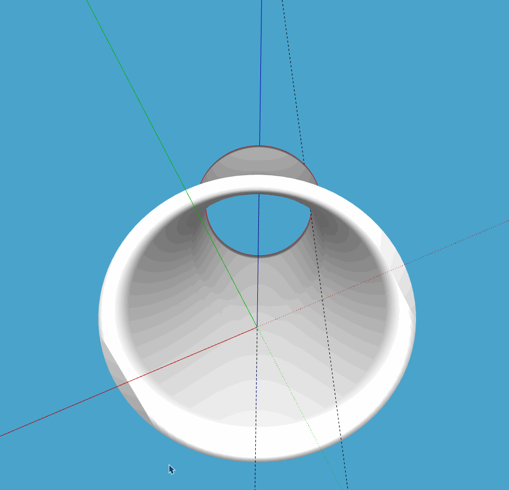

      im trying to do a simple follow me and the edges are morphing into something weirdjaryd trophy.skp

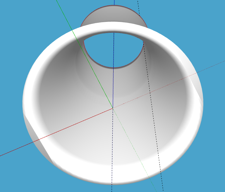

        What do you mean by that? The only thing I see is that the rim edges top and bottom are softened heavily.
        Easily fixed by triple clicking on the shape with Select then right clicking and selecting Soften/Smooth.
