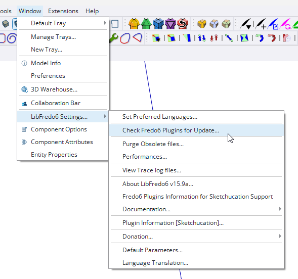

        Find the currently installed version of LibFredo6 by going to Window>LibFredo6 Settings...

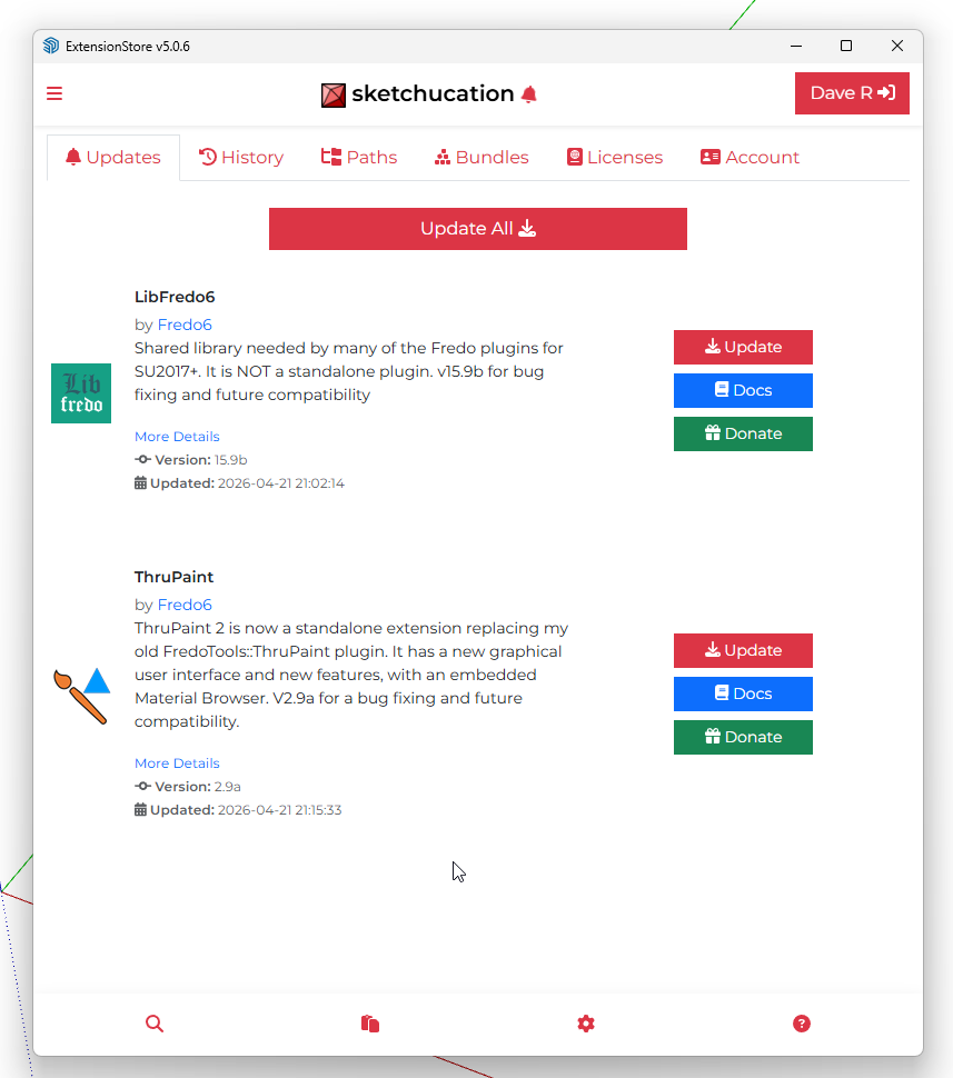

        Since you must have the Sketchucation Extension Store installed to manage the licenses for Fredo's extensions, open the Extension Store tool and use it to install LibFredo6 as well as any other extensions that need updating including the Sketchucation Extension Store. If you installed LibFredo6 and Fredo's extensions using the ExtensionStore tool it will keep track of extensions that get updated and let you know those updates are available. Here I've just opened the ExtensionStore tool and clicked on the red bell at the top. It shows there's an update today for LibFredo6 and Thru Paint.
        Clicking on the Update All button will update the extensions.
                    • E Offline
                      EricBreuerDesigns
                      That worked.
