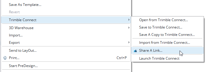

        You're looking at the old Trimble online viewer, not the SketchUp online viewer. After saving your file to Trimble Connect, use the Share a Link option from the Trimble Connect menu. Or you can do the same in the Trimble Connect web UI.

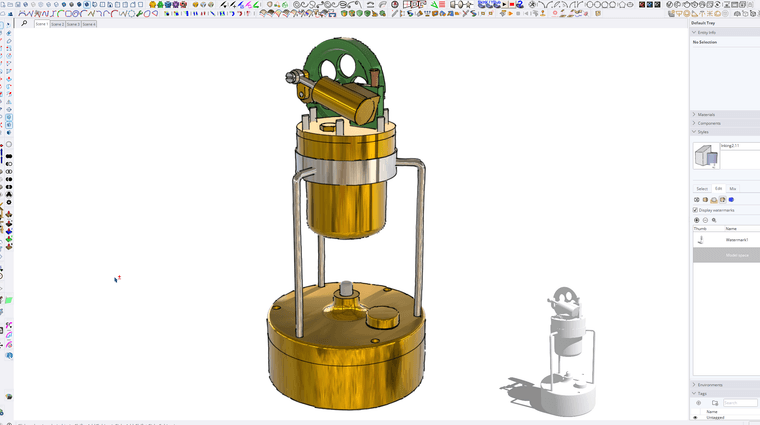

        The SketchUp online viewer will display the watermark. Here is a model in SketchUp with a watermark added in the style.

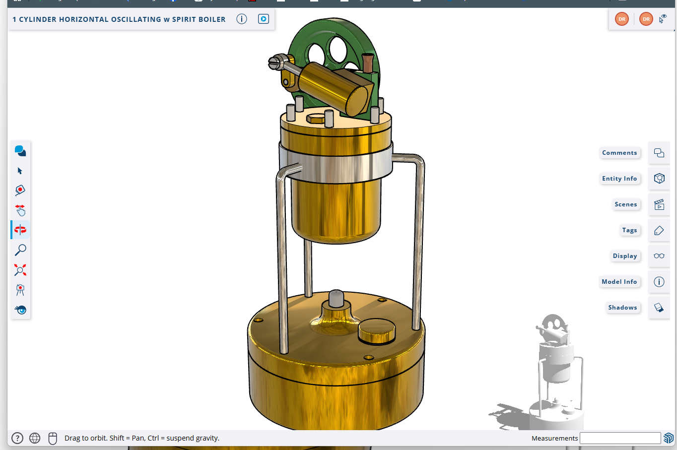

        And this is what it looks like in the SketchUp online viewer.
