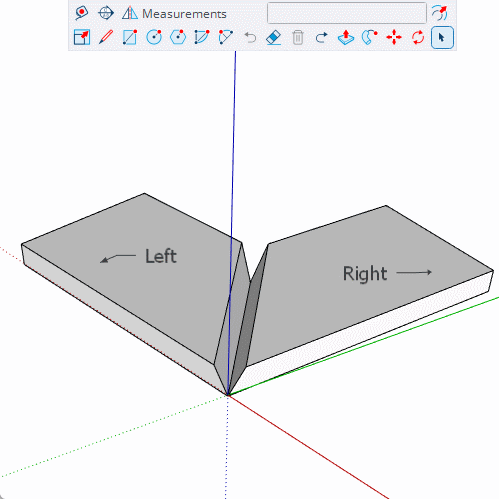

            Hi Rich,

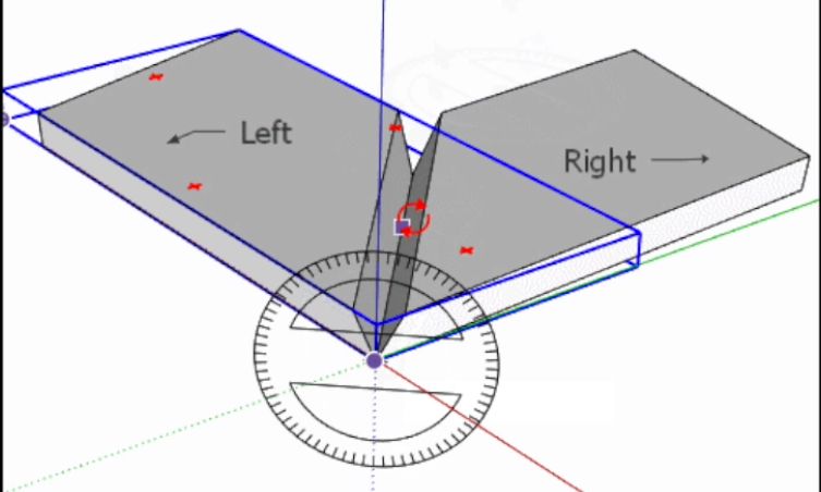

            Any chance you could use that snap for the other 4 points like this:
            No insult intended.
            I'm trying to see how off the finished star is.
            You can see that last snap (Labeled Right) is off.
            Lets say my 2mm if perfectly joined with the other 4 points.
            But I can't get the points left and right in Sketchup.
            So if they are already off on the first snap then multiplied by 10 to get the total discrepency.

              I did use Snaps and I get a misalignment at the end too.
              πŸ”» Download star-point[rich].skp
              So it would seem there is a small flaw in the modelling.
                Edit the group and right click and choose Make Snaps
                Here's a SKP file with Snaps at each corner.
                star-point[rich-snaps].skp
                To fully understand you would need to review the help docs I linked to earlier.

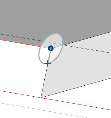

                  After click on the point where I want the snap.
                  It shifts to something similar to Axis tool.
                  Then it shifts to something similar to the protractor tool.
                    Yeah, so the CTRL key toggle from place to edit to erase. The behaviour itself is a little flaky because you need to move mouse off of a Snap to get the toggle to work.
                    It won't toggle for me if I hover a Snap and hit CTRL
                    But the basics is to place your Snap, orientate it appropiately and then place a Snap on the other object orientated in the same manner.
                    That way when you use the Move tool to grab the objects Snap it will snap to the other object's Snap orientation.
                      The initial Snap placement requires a double left click. So make sure your Snap is perpendicular to the face then double click to place it.
                      If you single click you then get it placed but it expects you to then orientate it. That can cause you to get disturbed by SketchUp's inferencing engine.
                      It's a little tricky to get the workflow but with practice it becomes relatively easy.
                      Personally, I'd tackle this Star Shape differently. Especially if you have exact dimensions. But everyone does things differently.

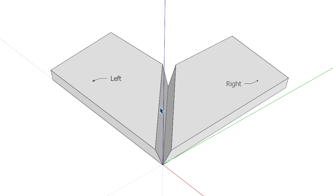

                                  I don't really get why you don't just make the shape you want and take the shapes from it.
                                  Here's a quick version where all points are the same and although I have used two components, the second is just a mirror of the first.
                                  B 1 Reply Last reply Reply Quote 1

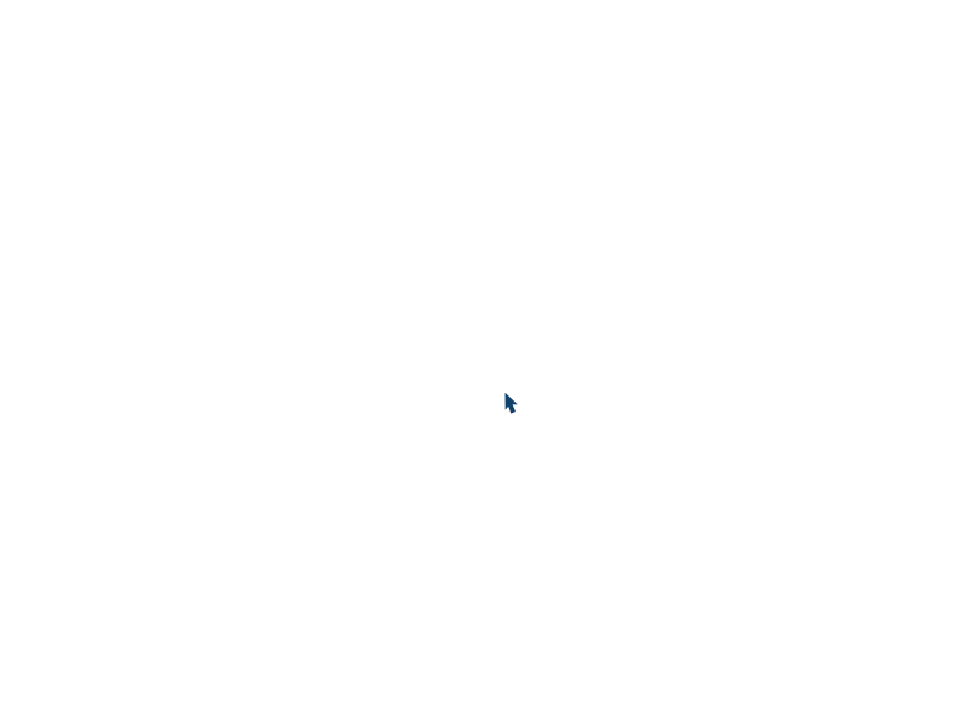

                                    • BoxB Online
                                      Box
                                      Without bothering with snaps.

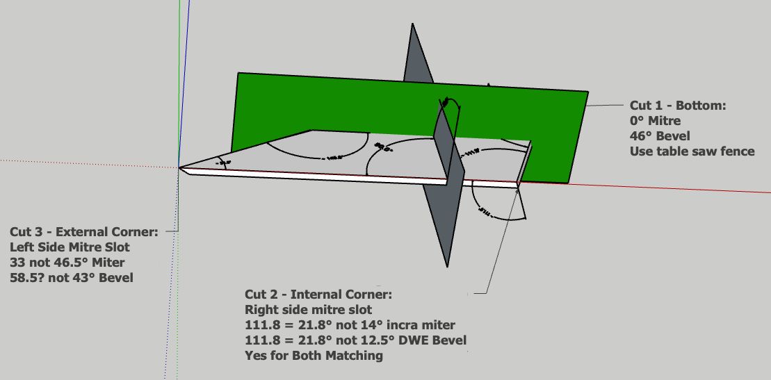

                                            Ok, now I'm back to where I was designing my table saw sleds.
                                            This design has me cutting 4 intricate cuts. Mitre and bevel on all 4 sides.
                                            My original design has me cutting just 3 intricate cuts.
                                            Leaving the 4th side (top) at right angle.
                                            But leaning/angling over to accomplish the same look.
