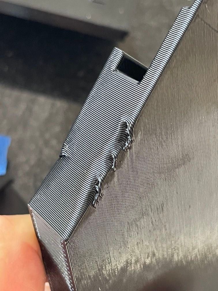

      Hi I’m having problems printing these corners.
      Any ideas?
        Leggy
        Everything is perfect apart from these areas
          Hard to say from just a single image. What orientation was the model in on the bed? What material?
            Leggy
            The base is where my finger is, so the layer lines go up from there
              Dave R @Leggy
              @Leggy said in Strange corners:
              So there's an overhang? Might need to add support. Check to see that all movements on the printer and the bed are tight enough. I had an issue on my printer where the screws holding the bed to the carriage were loose. Once in a while the bed would shift during a paid movement and cause a deformation in the print. I tighted the screws and the problem disappeared.
                Leggy
                Overhang is 45 so no support needed, support at ideamaker gave me a gcode for xy and it worked good
