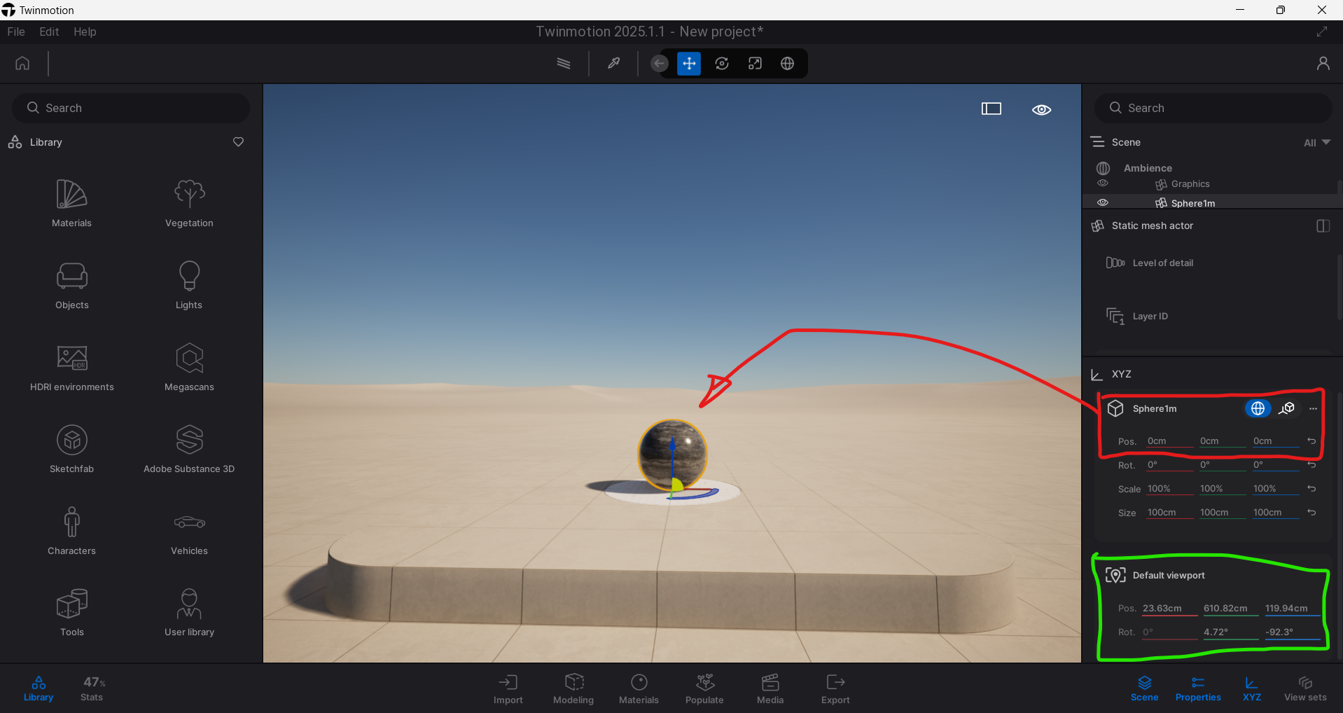

          In TM you have 5 values for the viewport(Camera)
          Position
          **X, Y, Z ** (the camera position based on world origin)
          Rotation
          X (always greyed) Y (the tilt in degrees) Z (the swing )
          Tilt is + up -down
          swing has values -180 to 180
