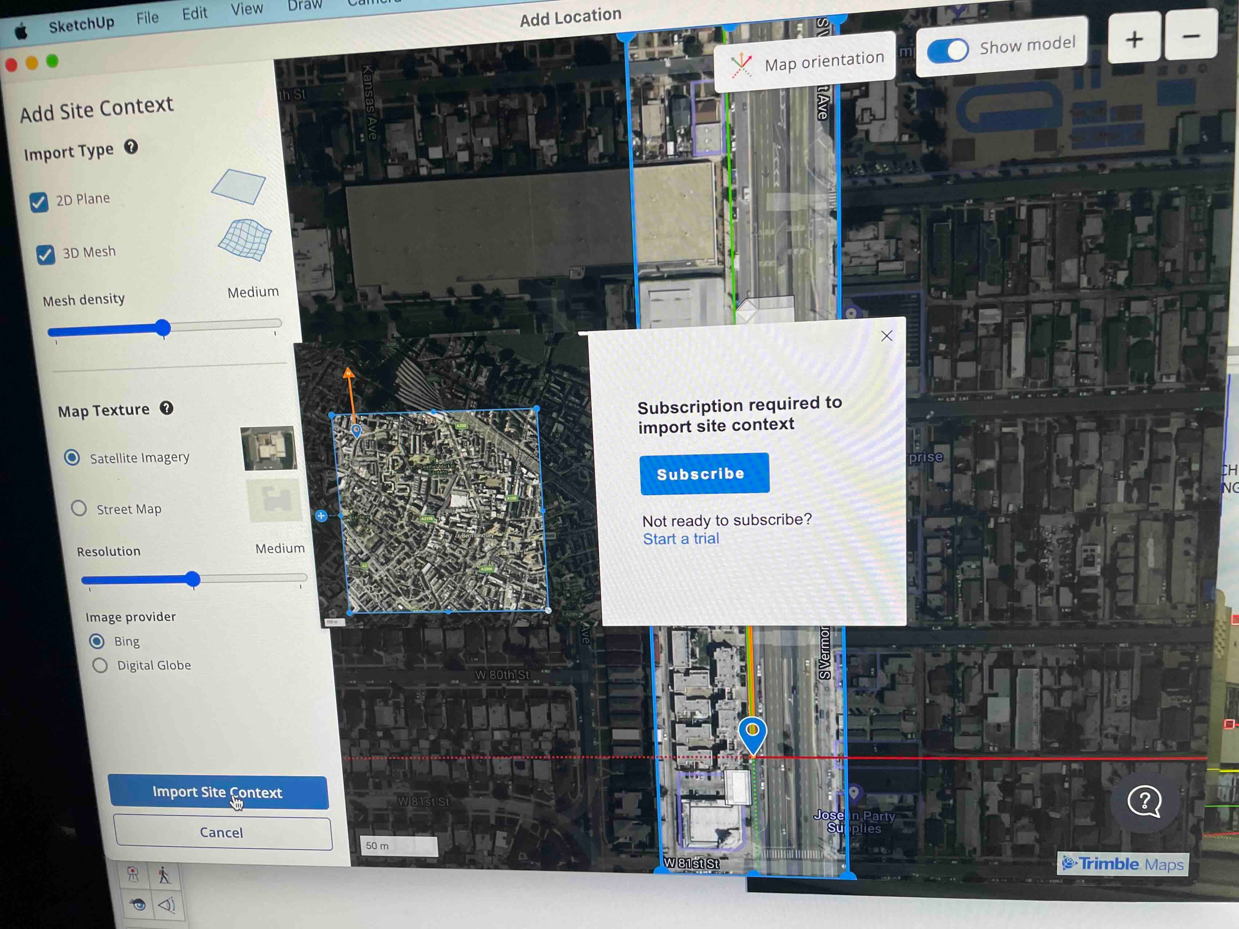

      dmorong
      I am working in a computer lab with edu licenses and when the students try to use the add location feature they are asked to first log in (no problem) but are then required to have a subscription. I have not run into this before. My personal edu version works fine. Not sure why the lab version is not. !IMG_7167.jpg

        Dave R @dmorong
        @dmorong The Add Location feature is not included with the EDU license (SketchUp Studio for Non-Profits) the school has. It requires a full subscription (Pro or Studio but not for Non-Profits.)
        Contact Creation Engine for more information on this.
        https://shop.creationengine.com/
