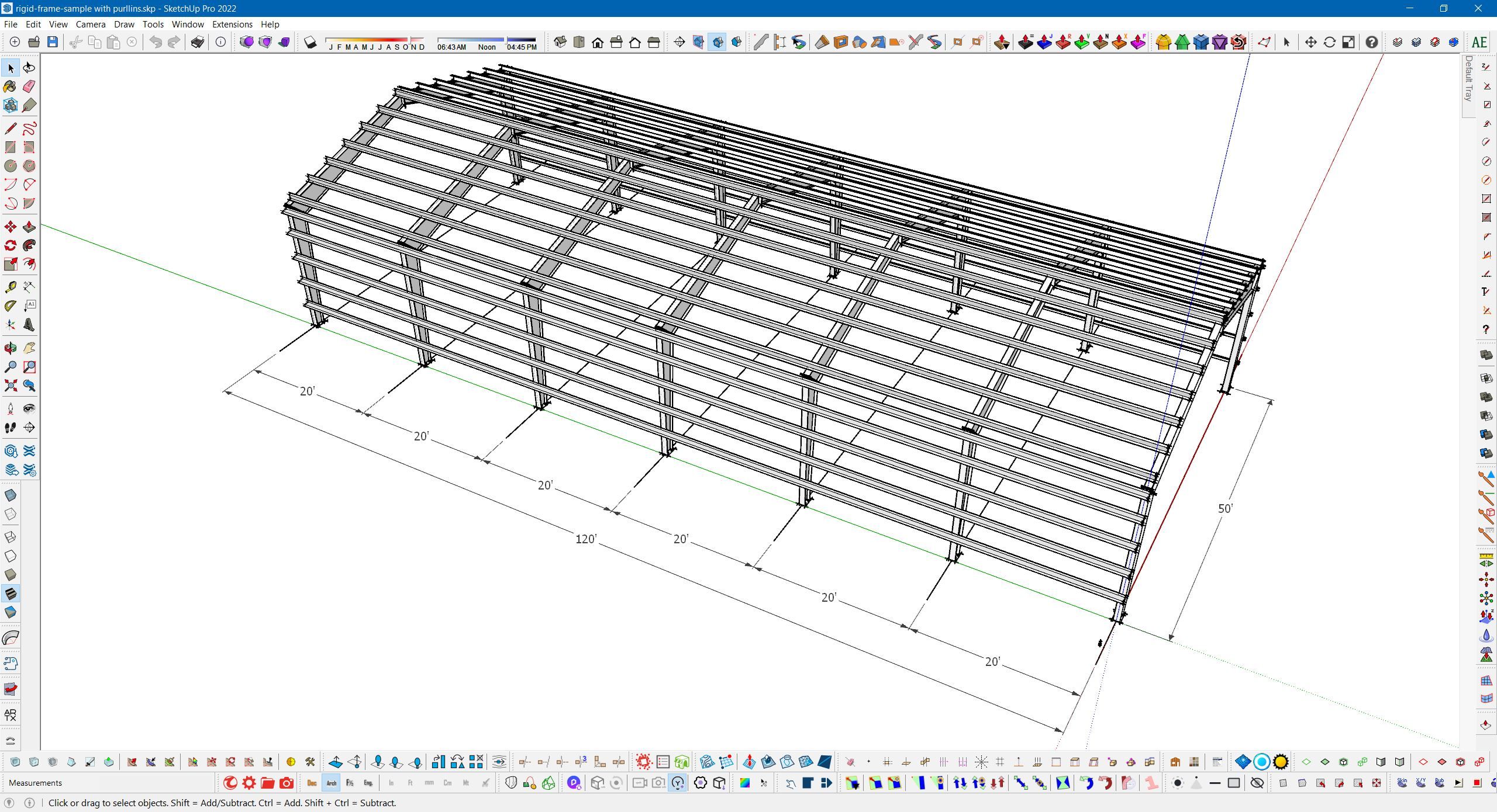

                • Gus RG
                  Gus R @Gus R
                  @Gus-R Here's a skp of the rigid frame with purlins.
                  rigid-frame-sample with purllins.skp
