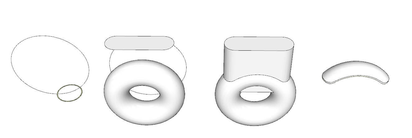

        Which version of SketchUp are you using? The exact method could depend on that. Your profile says you are using a version that does not exist.
        One way to go about it would be to start by imagining it as fitting all the way around the tire. Draw a profile and a circular path. Then draw the shape from the top view and intersect the two shapes. Then erase what you don't need.

          Hello,
          Thank you frankly you are too strong !!
          I did it!
          I would never have thought of this method.
          Thanks again !!!

            Happy that helped. 👍
