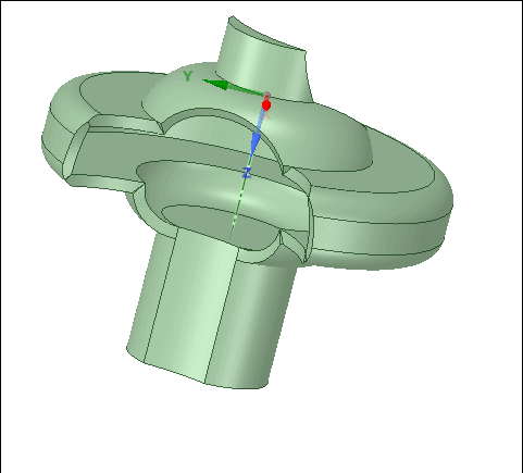

        The old one...
        http://moiscript.weebly.com/uploads/3/9/3/8/3938813/246251_orig.gif
        http://moiscript.weebly.com/uploads/3/9/3/8/3938813/837883_orig.gif

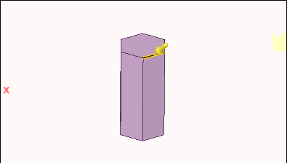

                Go to the head of the arborescence, draw a 3D SPhere
                and Right click on the head arborescence then click the enabled case Lock for "unclick it" !
                https://i.postimg.cc/T2FwJv39/unClick.jpg
                All will works fine! πŸ˜„
                https://i.postimg.cc/90rDFWF4/GIF-will-work.gif

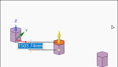

                    Direct modeling always fun! πŸ˜„
                    https://i.postimg.cc/dtCwBzg2/Gi-VIOLENT.gif
                    https://i.postimg.cc/qqTzryhR/Pifoul.jpg
