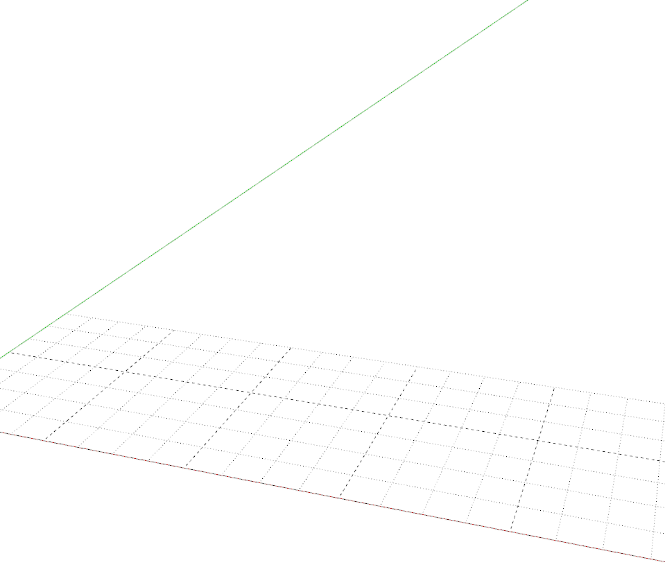

                            Version 4.7.0b - 07.20.2026
                            • Added a floating grid to the Custom wall draw and profile edit tool when the "Grid Snap" option is toggled on.
