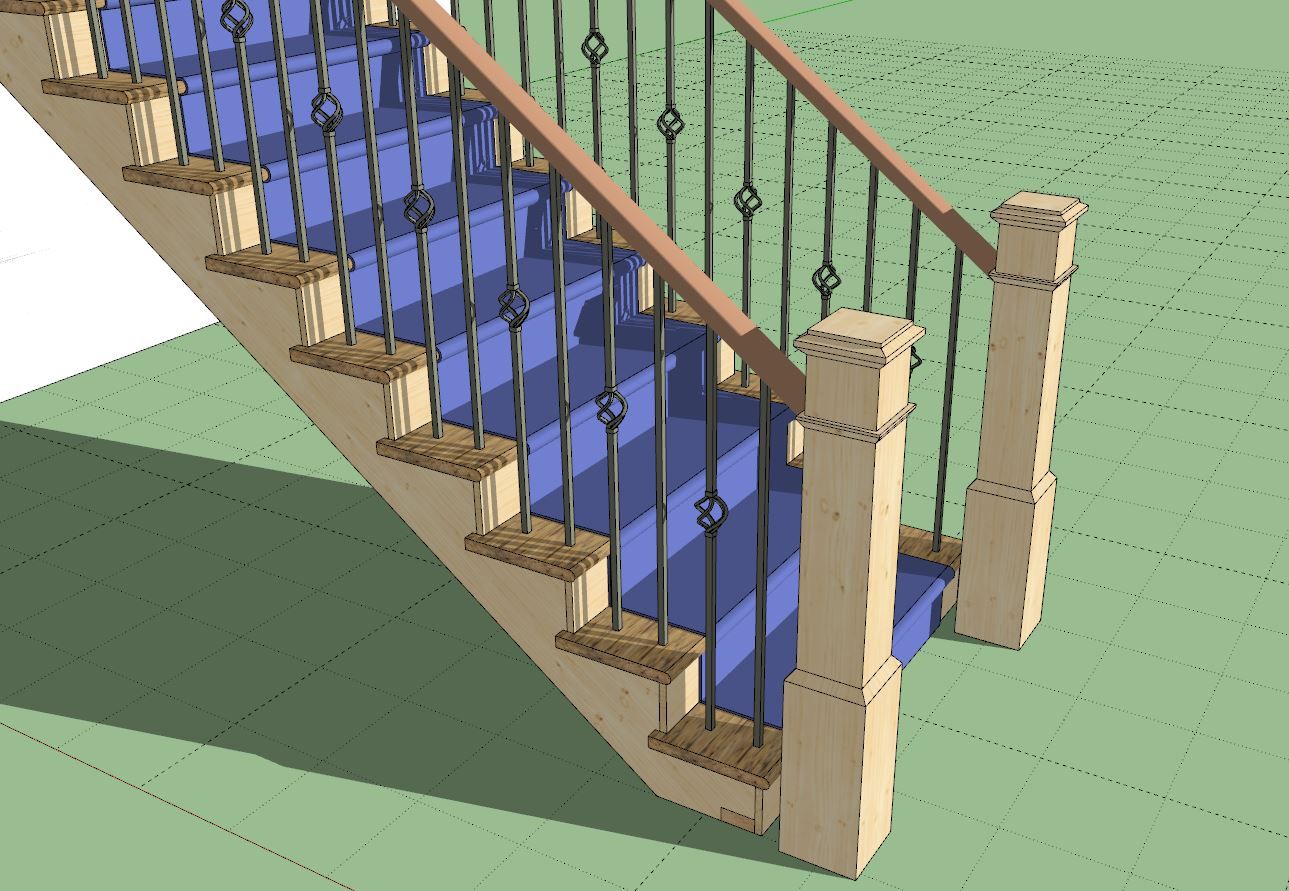

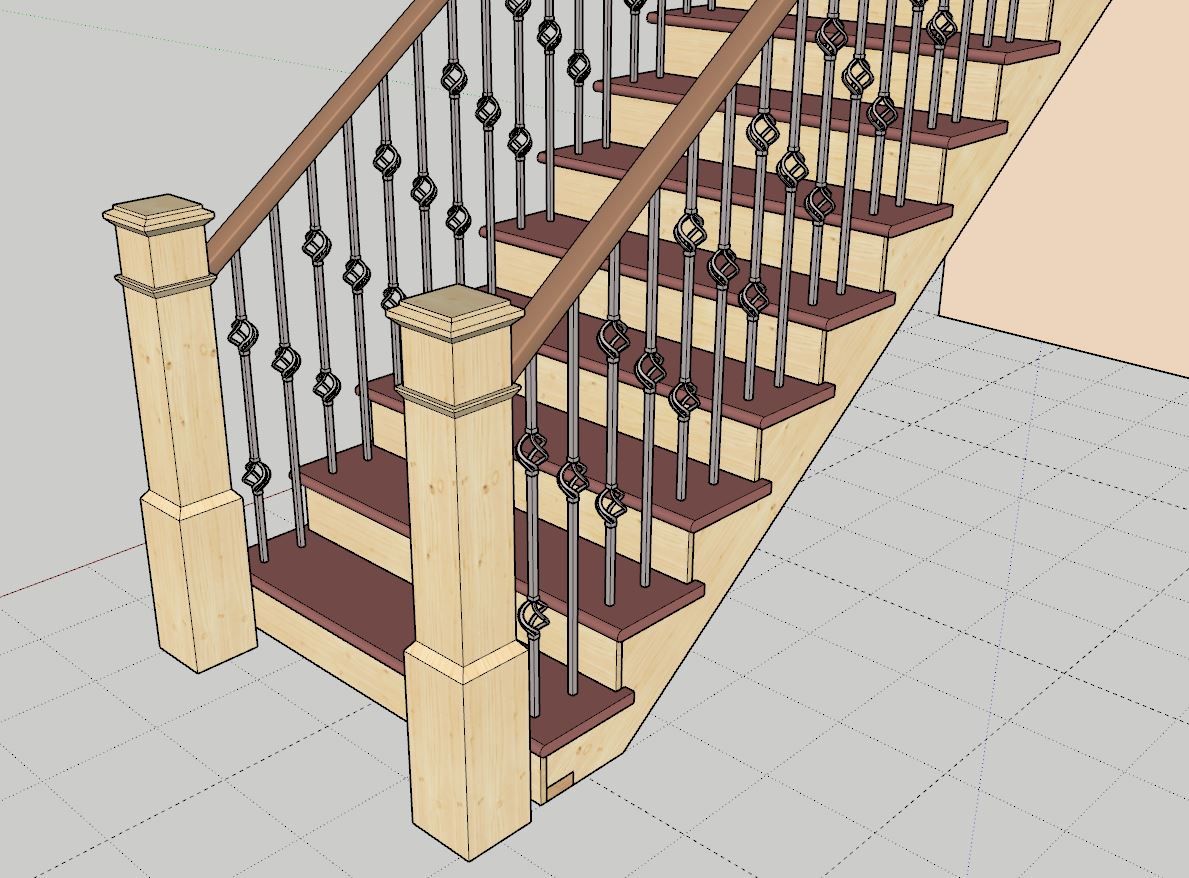

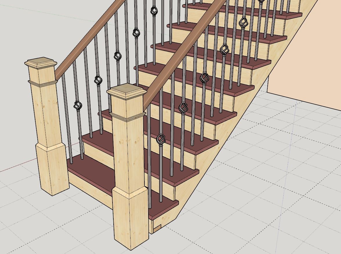

                        Version 4.4.8c - 04.19.2026
                        • Fixed a minor typo in the stair module.
                        • Added a ornamental iron baluster into the baluster component library.
                        The limitations of profile cutting balusters can be overcome by using a predefined component instead, which allows for much more intricate baluster geometries.
                        However as I have been researching various baluster layouts I've noticed that with iron balusters usually more than one baluster style is utilized. The typical scenario is two or three different baluster geometries are alternated along the run of stairs. I will need to give this some more thought.
                        Stairs can be a "rabbit hole".

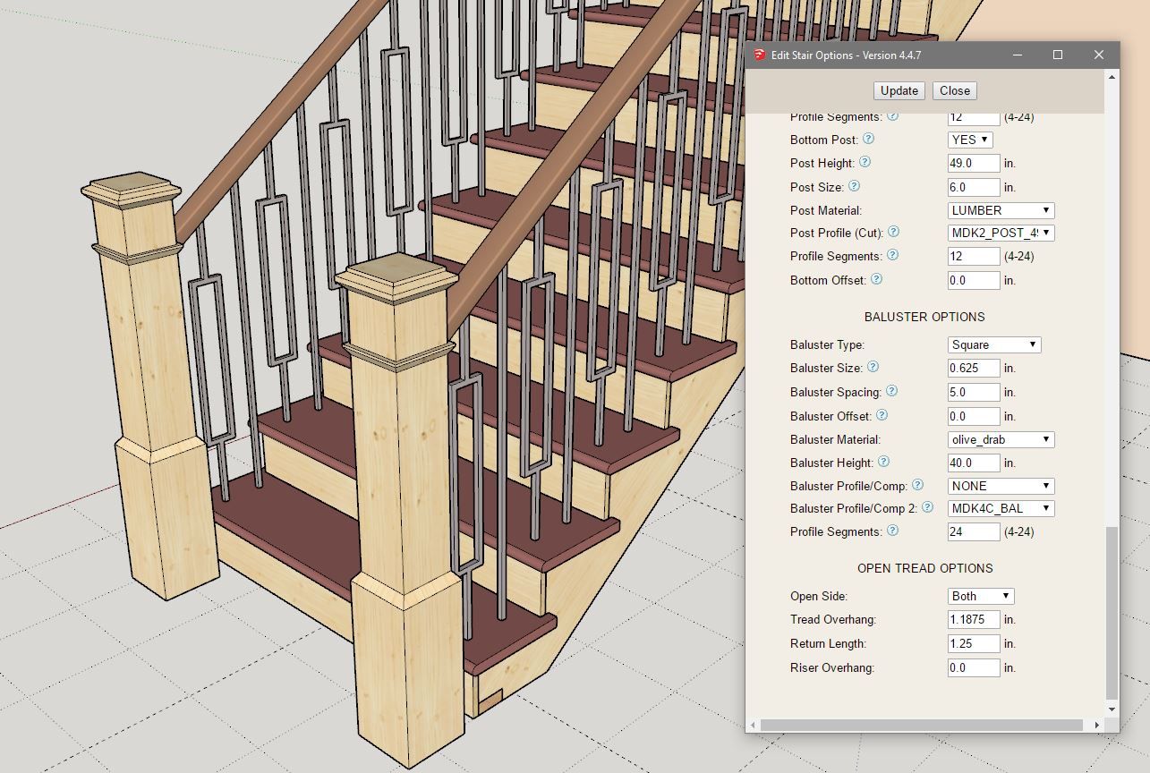

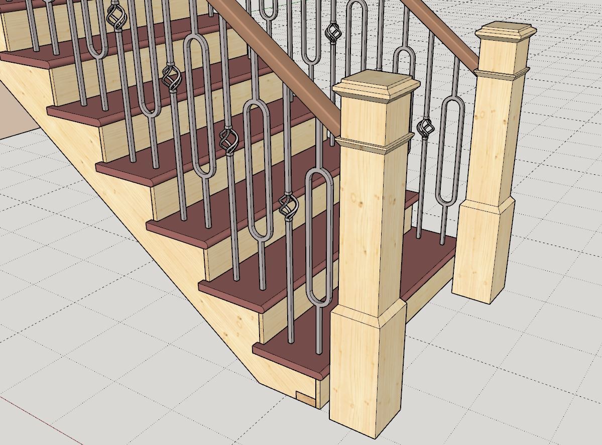

                          Version 4.4.9 - 04.19.2026
                          • Enabled a secondary custom profile/component parameter for balusters.
                          • Added additional ornamental iron balusters into the baluster component library.
                          I think I've beat this horse to death. Hopefully with this added option we can configure most of the common baluster layouts, however there will always be a few that will be beyond the scope of the plugin (ie. three or more baluster types in various repeating patterns).
                          Nathaniel P. Wilkerson PE
                          Medeek Engineering Inc
                          design.medeek.com
