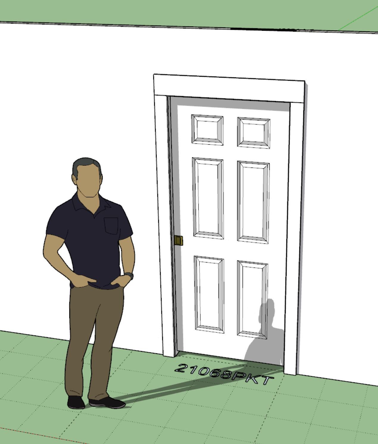

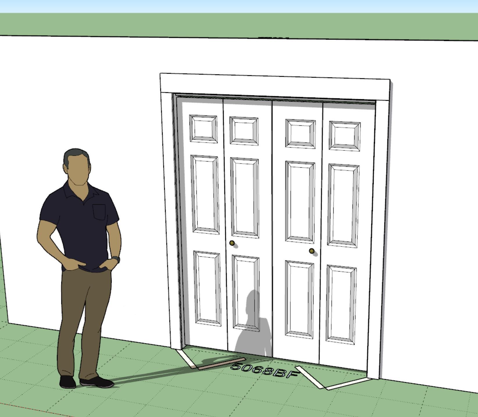

                          Version 4.3.1 - 02.02.2026
                          • Added a six panel option for pocket doors.
                          • Added a six panel option for bifold 2 and bifold 4 doors.
                          • Added a six panel option for bypass doors.
                          Nathaniel P. Wilkerson PE

                          • medeekM
                            medeek
                            Version 4.3.2 - 02.05.2026
                            • Added flat panel options for pocket doors.
                            • Added flat panel options for bifold 2 and bifold 4 doors.
                            • Added flat panel options for bypass doors.
                            wall_su1070_800.jpg wall_su1071_800.jpg wall_su1072_800.jpg wall_su1073_800.jpg wall_su1074_800.jpg wall_su1075_800.jpg wall_su1076_800.jpg wall_su1077_800.jpg wall_su1078_800.jpg
                            I think that finally completes all of the door panel options for all the other non standard door types (rectangular doors) within the Wall plugin.
