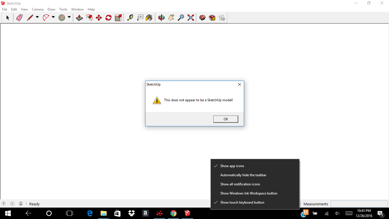

      I can't figure out how to get Curviloft to download where it is usable. It downloads, but when I try to open it, I get this:
      What am I doing wrong???
        Plugins and extensions are not files you open in SketchUp like a model. Go to Window>Preferences>Extensions. Click Install Extension... Naivgate to where you saved the file, select it and choose Open. Then the affirmative answers to the next questions.
        Better would be to install the Sketchucation Extension Store from the Resource menu at the top of the Sketchucation screen. Then use it to auto install other plugins and extensions.
        Don't forget, you also need to install LibFredo6 to make Curviloft usable.

            Thank you! It was driving me nuts. I've played with Sketchup a bit but never downloaded any plug ins. Now maybe I can figure out how to use it. πŸ˜„
