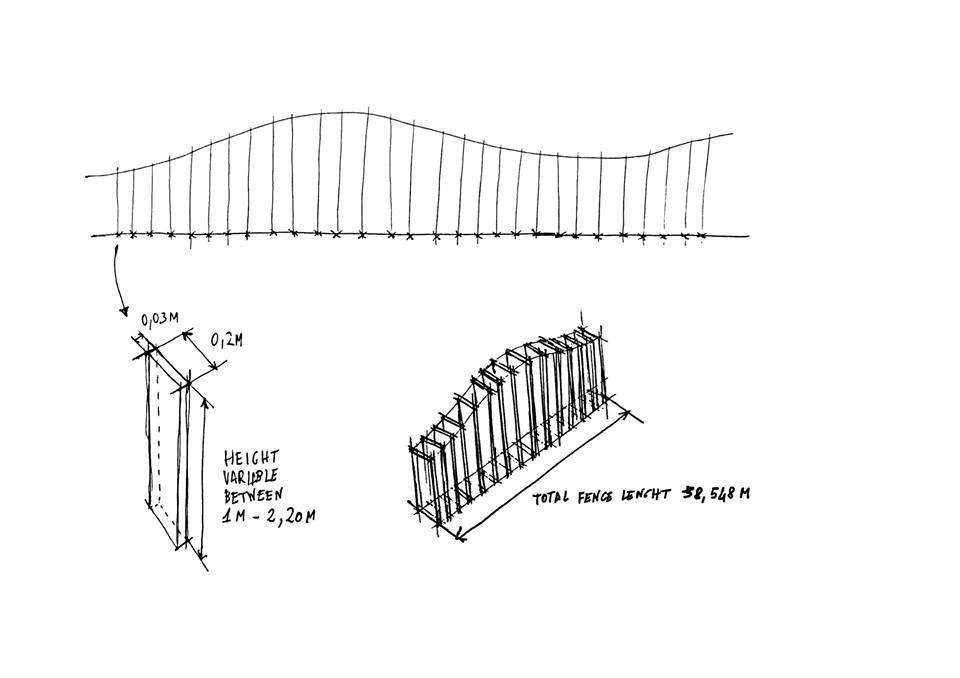

      Hi to everyone. First of all I apologize for my poor english. I want to make multiple copies of a post varying the height along a curve and mantainig it's base section at the top. How can I do that? I'm attaching a sketch of what I want to do.

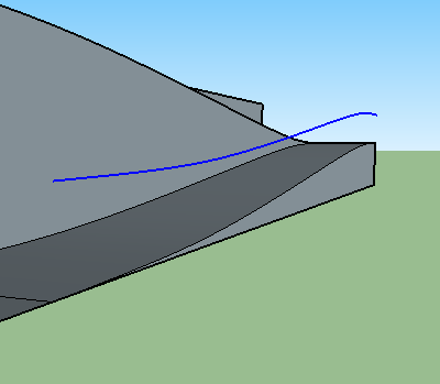

        Draw the posts a bit extra long. Each one should be a group or component. Make a sold group or component with the curve shape on the bottom to use as a "cutter". Then use Trim from the Solid Tools selecting the "cutter" then the posts one at a time.

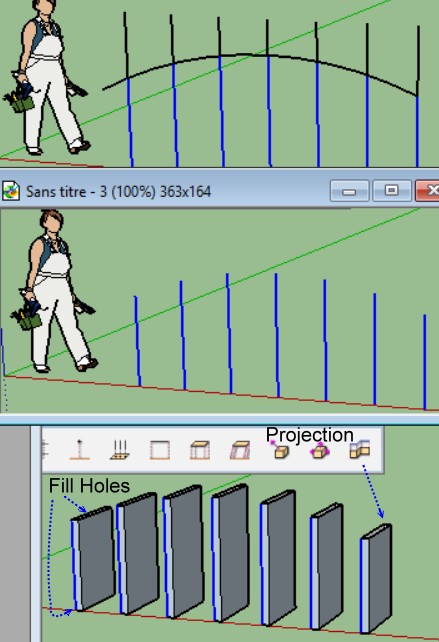

              @pilou said:
              With SkatchUp Make I will make that πŸ˜„
              Draw some vertical lines Intersected with one curve
              Select all lines
              Use Draw Extrude Line along a vector (Inside Projection By Didier Bur)
              Select all / Make Top and bottom caps (Fill holes by Tig )
              [attachment=2:agajs7kx]<!-- ia2 -->variante.jpg<!-- ia2 -->[/attachment:agajs7kx]
              [attachment=1:agajs7kx]<!-- ia1 -->GIF_proj.gif<!-- ia1 -->[/attachment:agajs7kx]

                With SketchUp Make I will make that πŸ˜„
                Select all lines
                Use Draw Extrude Line along a vector (Inside 🀣 Projections By Didier Bur)
                • Dave RD
                  You could still use the method I suggested.
                    Something like this πŸ˜„
