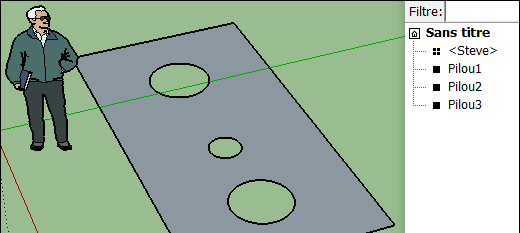

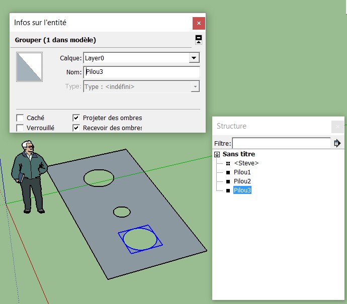

        I am not a Ruby man but I suppose you can! πŸ˜‰
        Just use Group(s) or Component(s)
        Here Goups! Rectangle is not a Component, but that will be the same with a Rectangle Component! (Edit Component...)

          I dont have the same view.
          When I select the circle, I have no name field in the entity info.
          How can I display the sructure of the group ?
