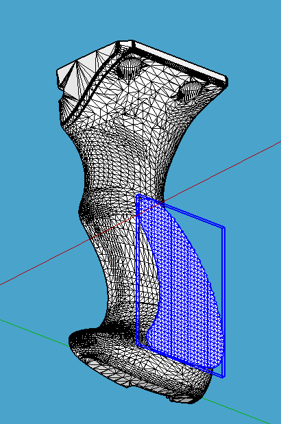

      I am making a pistol grip (I did not designed myself, it is an STL import from another CAD soft) and in order to get a good grip on both side of the pistol grip I would like to add some knurl (or so called) texture to each side but I cannot find out how to do it. I draw the knurl texture (which is mainly pyramids) and multiply them to get a large surface then I cut the shape I want to apply on the pistol grip side but the textured knurl is flat and the pistol grip is totally curved. See attached pic for further details
      Is there a way with sketchup to apply that flat textured volume to the curved surface as we can do with a regular picture texture, or sketchup is not able to do that?
      Thank you by advance to all the people for your future help.

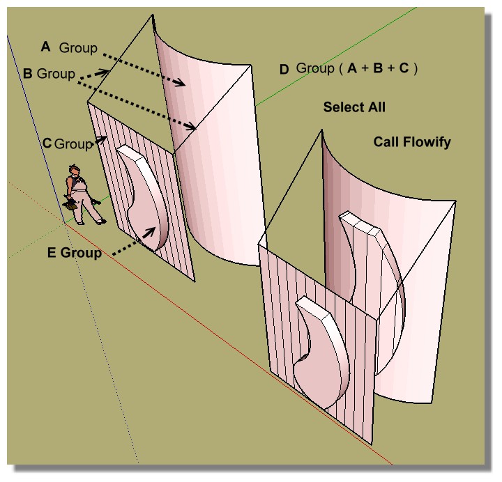

        Take a look to Flowify by Caul πŸ˜‰

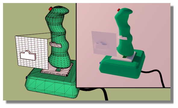

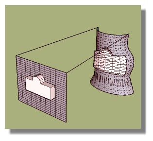

                    Huhu πŸ’š
                    Seems simple ! πŸ€“
                    Just take a part of your model! πŸ˜„

                        but it is not easy to isolate all those triangles to make a square
                        Very easy! πŸ€“
                        Look at your model : you have all horizontal & vertical parallal lines! πŸ˜‰
