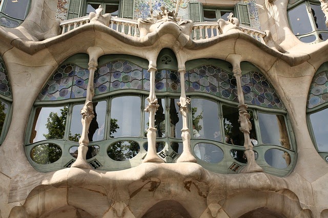

        Funny! 😎
        Nothing about circle or round forms? (Front or Top )
        http://s6.postimg.org/ygw1nxevl/vitres.jpg
        http://s6.postimg.org/6uta38vip/vite1.jpg
        http://www.freddy-bernard.com/images/jpg/p2-produits-92.jpg
        http://4.bp.blogspot.com/-_h7uzI1paHU/VMd1EYV7LKI/AAAAAAAAAcE/fzlDM9Y66yY/s1600/fenetre-gaudi-barcelone.jpg

          @pilou said:
          Funny! 😎
          Are the above images from a plugin or dc you've made? (they look familiar 😄)
          I started this dynamic component out of a need to quickly populate sketch models with all sorts of (straight! 😄) windows. And I mean, really quickly! I know there are many plugins that do windows out there... For me, most of them go into too much detail. Or they are too slow or inconvenient... I'm sure I may have missed a few that could be helpful.
          I can imagine how to make windows round in front... Would you need that? On top... that would probably be a bit more difficult.
          As for Gaudy! I think only he would know how to make a DC for his windows 😎
