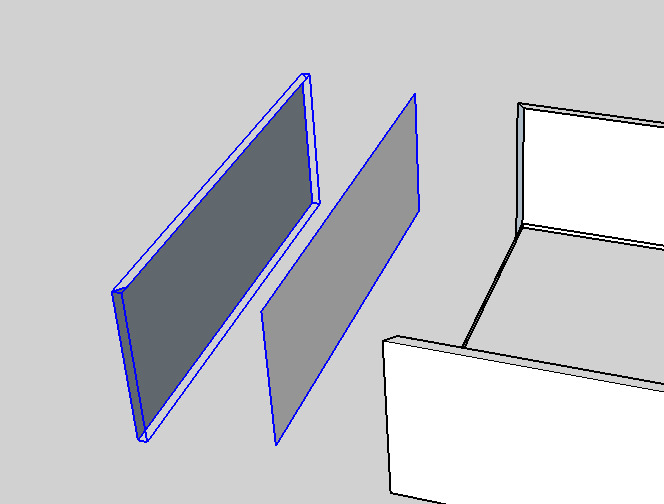

            It's no wonder you can't push your holes for windows and doors through the walls. The inside faces are different components than the outside. Evidently the imported 3ds file needs some help after you get it into SketchUp. What application did you use to create the 3ds file? The inside and outside faces should be wrapped in the same component or group wrapper. Generally, all the walls for a floor would be put within the same component or group wrapper.
            I would suggest that you start with a simple single room and learn to manage the group or component and use the basic tools before trying to draw an entire house.
            After putting all the first floor walls into a single group and doing some other clean up, it is very easy to put opening in the walls.
