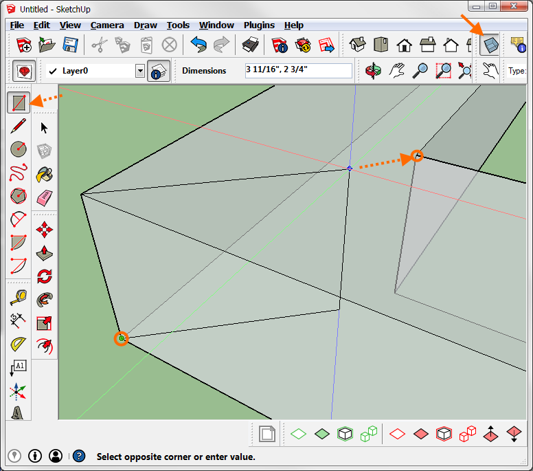

        You could try slicing the corners, by switching to X-ray mode, and using the RectangleTool:

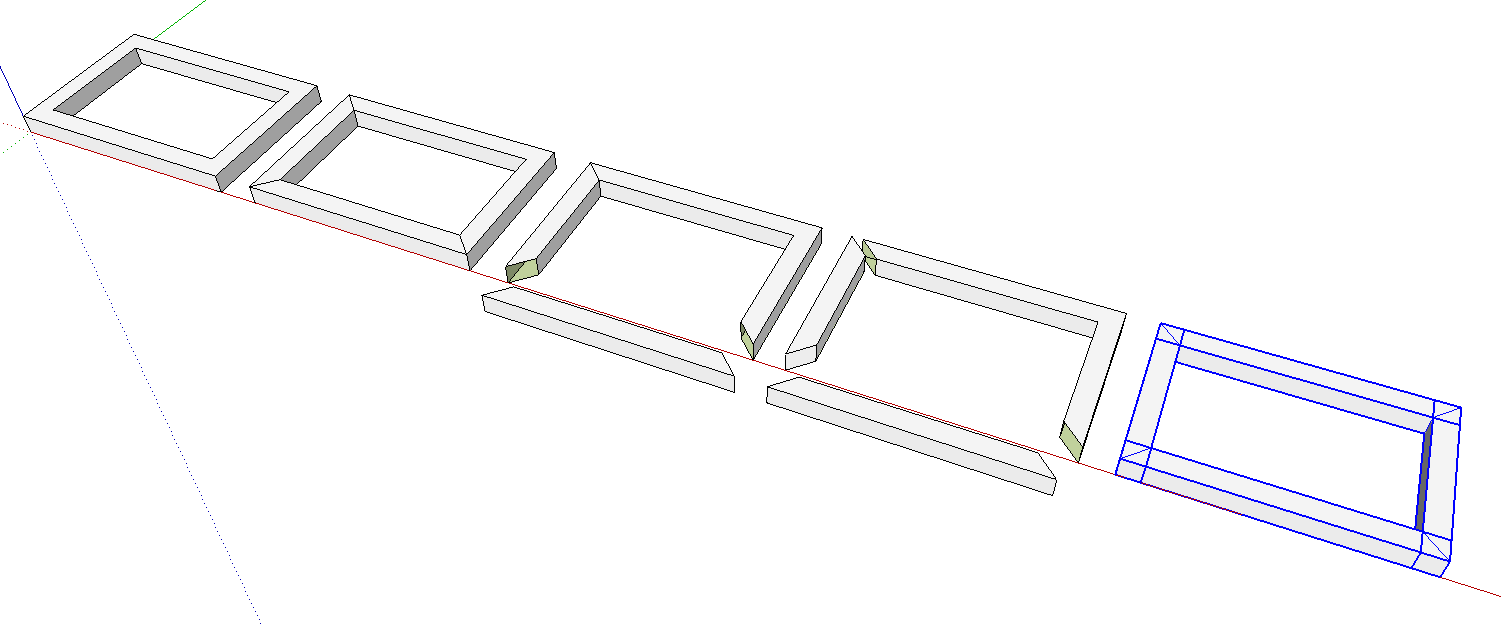

            Carl, there are several ways to draw the miter but first, if you want the cutlist to report each piece you'd cut from metal, then each piece needs to be a discrete component or group. Using Follow Me can be a quick way to create the frame but then you need to divide the result into sections. Maybe it would be easiest to start with if you just draw in the miter lines to divide the faces. There are other ways to do it but this will be straightforward and you can use the Line tool for that. After drawing in the miter lines you'll need to separate the geometry into components.
            Let's assume you've drawn a rectangular frame laying on the ground plane. You'll draw in the miter lines on the top and bottom faces connecting the inside and outside corners. Then orbit into a top view and use the Select tool to drag a left to right selection box around what you be one side of the frame. Hit G to make it a component. Make sure to tick the box for Replace selected. Also give it a name if you wish.
            Repeat the selection and component creation for one of the sides. remember its a left to right selection and tick the box for Replace selection...
            You could work your way around the frame doing that but if it is a rectangle, you can delete the remaining geometry and make copies of the first two frame sides making sure to flip them so they are oriented the right way.
            Now with your model set up that way, you can get something useful out of the cutlist.
              Here are the steps illustrated. Going from left to right.
              Frame created with Follow Me or the Rectangle tool, Offset and Push/Pull. (I did the latter)
              Lines drawn in at the corners. Note that I only drew miter lines at three corners. There's no need in this case because the back and right sides of the frame will be discarded.
              Left to right selection box was dragged around the front frame member's geometry and it was made into a component. I moved it away from the frame only to show it is separate. Normally there'd be no need to do that.
              Repeat the process on the left side.
              Delete the rest of the geometry from the frame. Copy (with Move/Copy) the left side over to the right. Right click on it and use Flip Along>Component's Red to make a mirrored copy. Copy the front one to the back position, flip it along the Component's Green and make sure it is in place correctly.
              Fini!
