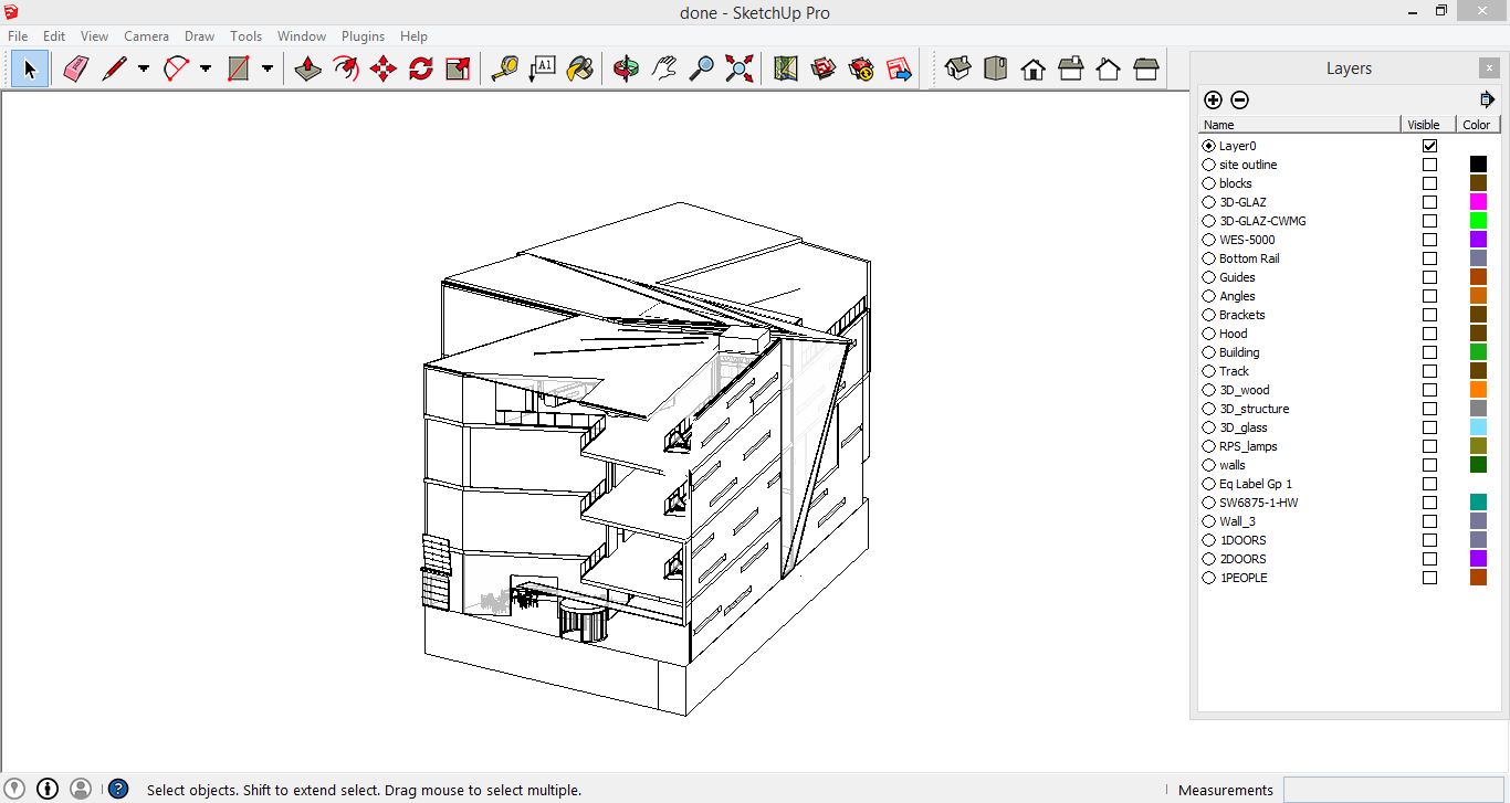

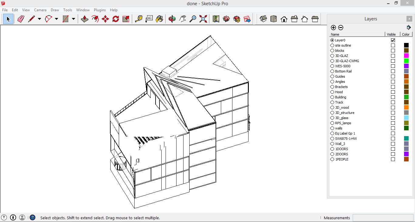

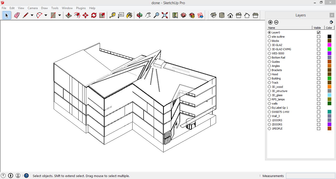

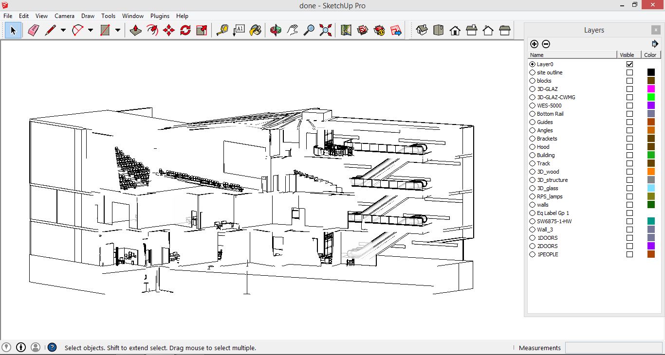

still slow? can you even post a few screenshots of your model? anything will help!

are all your chairs and imported furniture components? Have you tried deleting parts of your model to see what's causing the problem? This is the only way to determine what's causing the stickiness. It is quite a large model, but no reason why it can't run smoothly with proper use of components and layering.

After looking at your images, I would start by removing all the imported components like the chairs etc. I have said a few times imported components can be VERY heavy poly. In your theatre there are loads of imported chairs that could be slowing things down. I'm not saying that's the only problem but start there.
Have you actually tried deleting parts of your model, then PURGING it, then seeing if it's any quicker? This is the only way to see what is causing the problem.
