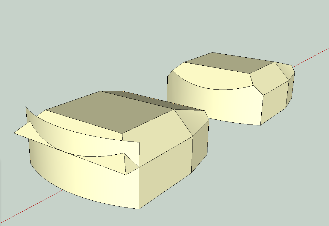

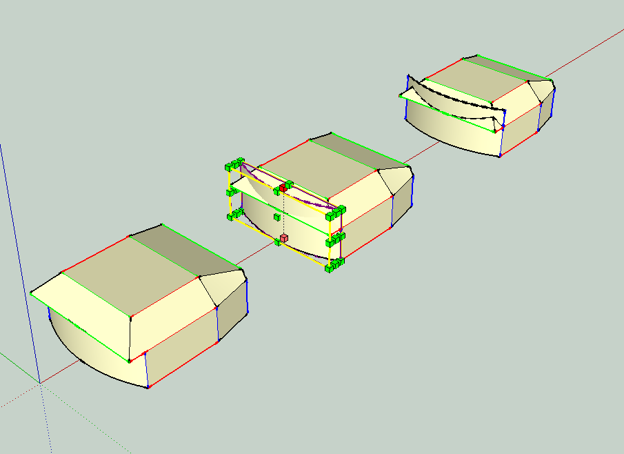

        I think what you describe is another slanted plane that cuts into the curved wall on the fourth side.
        This may be a call for "intersect faces" which is in the context menu and also in edit menu.
        You draw the curved wall and the slanted surface (make it long enough to cover the arc of the wall. Select the curved wall surface (double click) and group it. Scale that group up so that it completely pokes up through the slanted surface. Select all the other faces that will need cutting and select "intersect faces / with model" That will create the intersecting edges. Now if all goes well you can ungroup the curved surface. That surface and the sloped surfaces should all be separated now by the intersect edges you created and you can double-click on the unwanted faces, group, and delete them. (group each one after double click or multiple select, doesn't matter).
