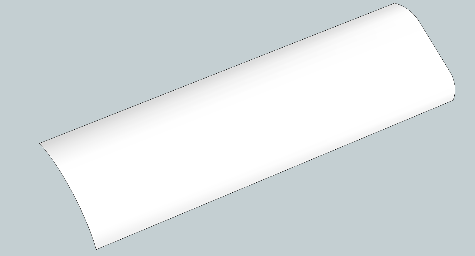

        Try welding the curves.
        You could also use Curviloft.
        Roof profile test 3.skp
          For weld some curves Recurve by Diggsey πŸ€“
