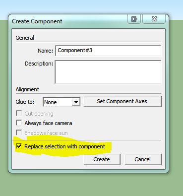

          It's possible that you are creating the second side and bottom while you are still in the first component for editing. Make sure it is closed when you make the second side.
          Also check that you aren't missing the little box on the component window which says, Replace selection with component. If this is unticked you are creating the component but also keeping the loose geometry.

                I did make sure the "Replace selection with component" box was checked in the component box.
