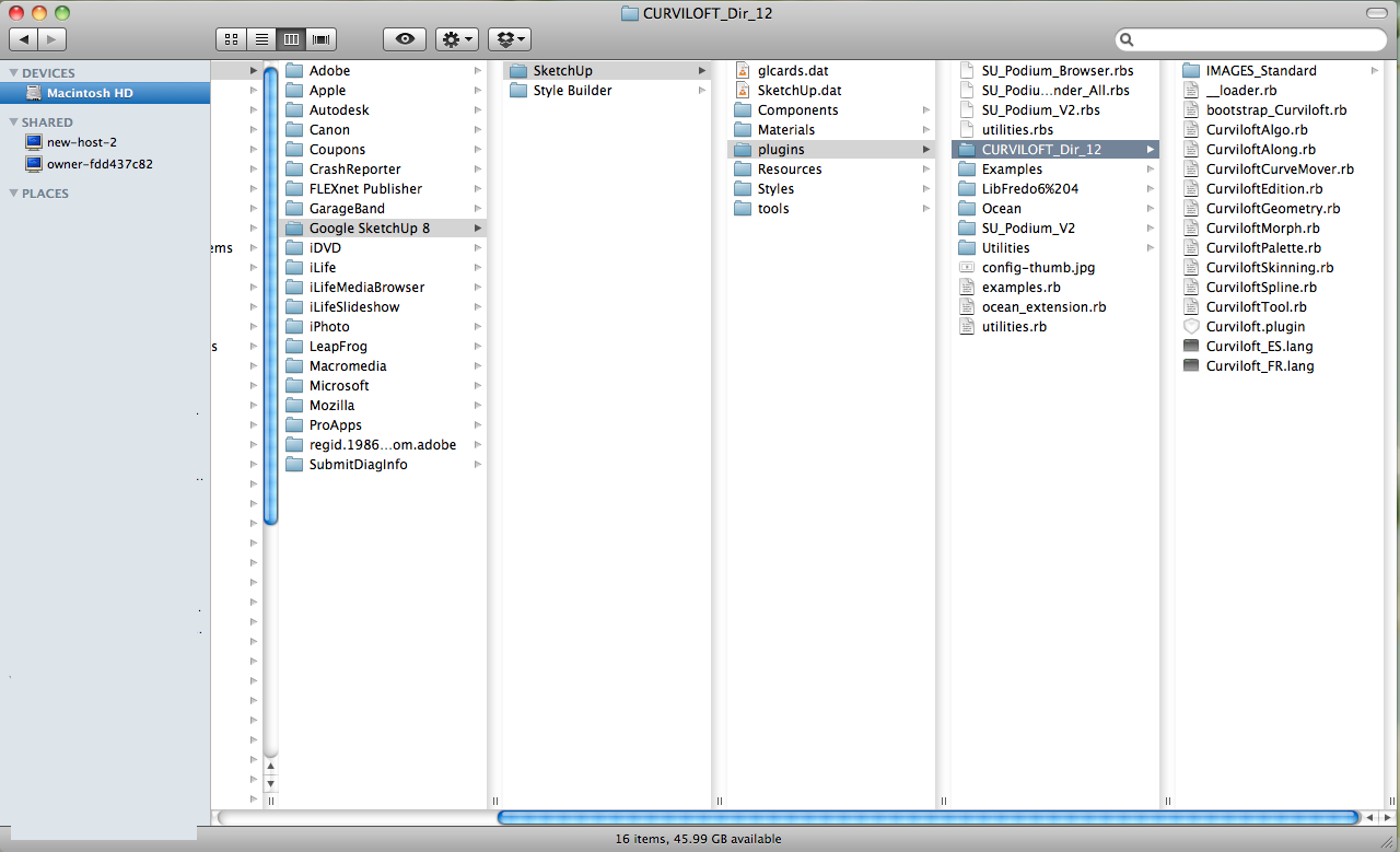

      Hello, I am using the Sketchup 8 on my MacBook Pro. I downloaded the Curviloft plug-in and followed the installation instructions, however when I opened SKetchup after restarting my computer, I did not see any new plugins in the toolbar. Could someone help me resolving the issue?

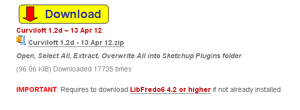

        You did a nice job of getting Curviloft installed correctly however you missed installing the required LibFredo6 files as indicated in the thread where you got Curviloft.
        Install it as nicely as you did Curviloft and restart SketchUp and you'll be in good shape.
