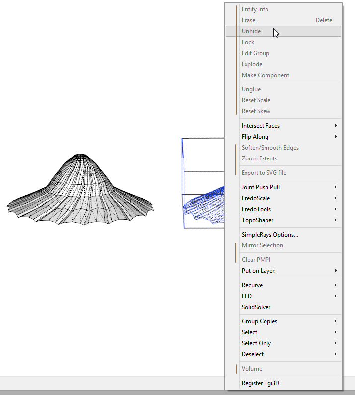

Grey Out Issue is back
Anyone else getting grey-out?
I am also getting it recently.
Me too but thought it was just me or something to do with my recent addition of twilight. Save and reopen fixes it but it is annoying.
:s
Uh... I thought it was fixed...
I've not seen this - so far... -
It even greys the menu item.
Never paid much attention to the old grey-out dilemma much but did it affect the menu entries also?
Yup.

The first thing I notice is that I have double the amount of plugins loading !
So what is different?Here's what I don't have loading and you do...
You have some early loaders that I think you use to group menu items...
####camera.rb ####misc.rb ####TIG.rb **##hideEverythingElse.rb**

I have emboldened some of my initial suspects [with NO proof - just gut-feeling! - the .rbs ones I can't look into anyway!].Can you try disabling some of them, restart and see if the gray-out issue continues ?
You have some 'bit-hitters' in there so I'd be interested to see what's what... -
