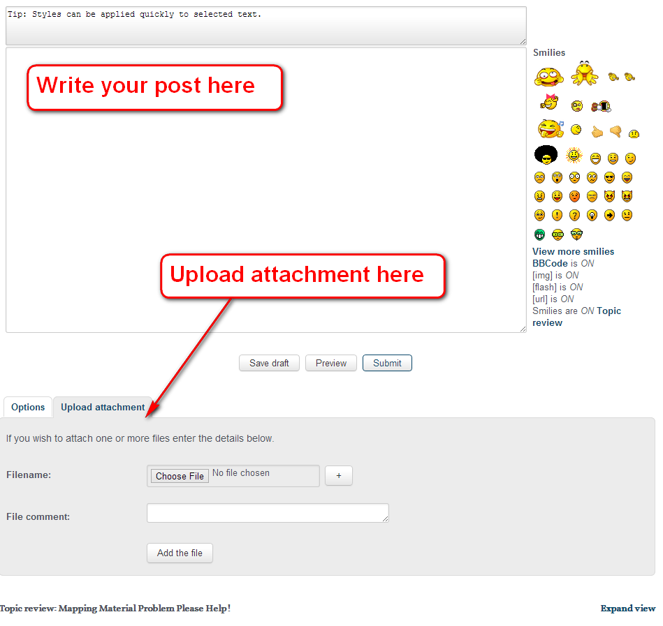

        No image there. Could you rather upload it to your post (edit it and under the posting area, there's an attachment tab).

          Please help me through how upload img here.
