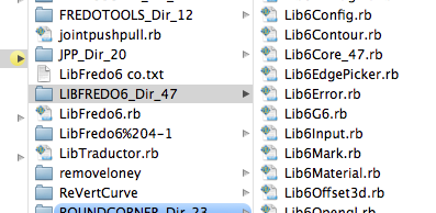

As requested I took a snapshot of the plugin folder in my sketchup 8 pro file system. Please let me know if this gives you guys a better idea to what I am doing wrong. Thanks in advance.

Tools on Surface and Libfredo6 4.7a are not installed correctly. Notice the '%' in the folder names. Essentially you haven't maintained the file structure as outlined in the first posts of those threads. Somehow you managed to install Libfredo 6 37 correctly. Notice how the folder name is correct.

Notice the '%' in the folder names. Essentially you haven't maintained the file structure as outlined in the first posts of those threads...
Dave %20 is added for the internet to any download 'file name' with a space in the 'file%20name', it looks untidy, but in itself will not stop the file working, they can be replaced with a space, to look right.
john -
John, I know it is added but I've never seen a plugin file work with the %20 shown in the name. Removing it has fixed it. And if that isn't qwalsius's problem, can you tell him what is?
