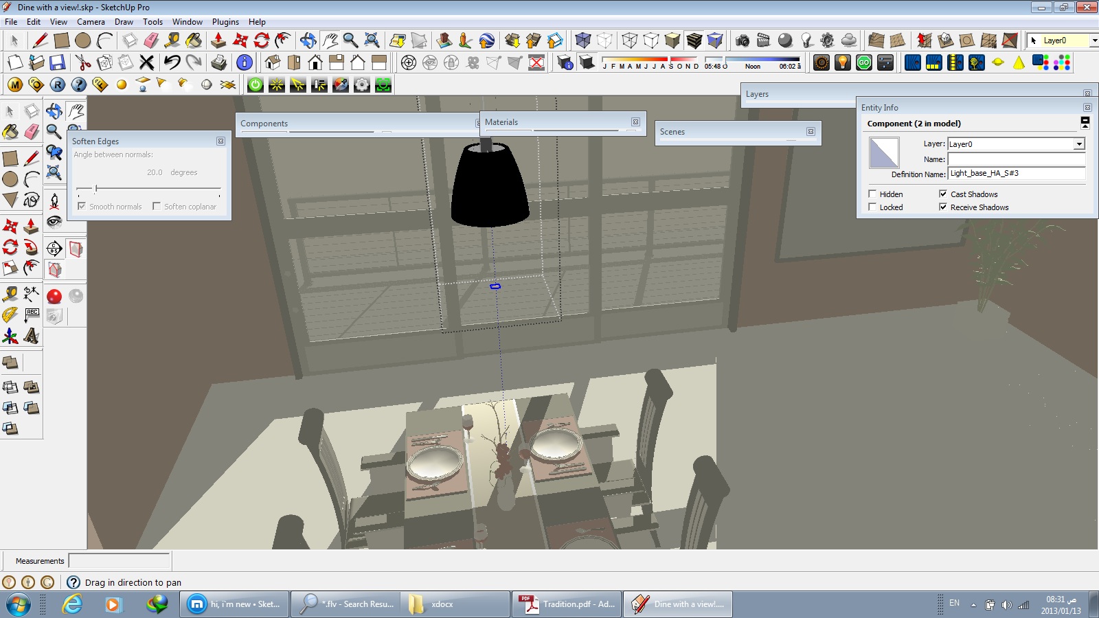

      Can anybody please tell me what program or plugin is used to create the " Light_base" component, cause I`ve been searching everywhere with no luck, many thanks
        It would help if you would explain what "the " Light_base" component" is. Maybe you could post an image?

          the thing is when i search for component ,or 3d warehouse object i get some very nice rendrs with the su file , any light source , ie spot lights etc in the render produce a very nice light distribution when inspect the light unit i find a circle in the component named light _base i presume it is creating the proper light effect .
          the attached pic show this matter
            Which light component is that specifically? Is it one from the 3D Warehouse? It would appear that it is intended as something related to an external rendering program. If that is the case, I expect you need to sort out making it from sources familiar with the rendering program.

              "Light base" is probably just a name someone used for a light source component.
              These are made by a plugin for exporting to specific a rendering program. I see that you have icons for the Kerkythea export plugin. If you are using Kerkythea, then the yellow icons that look like Saturn and a cone are the ones that create a light source.
              I see other icons that look like rendering plugins as well. Depends on what rendering program you are using.
