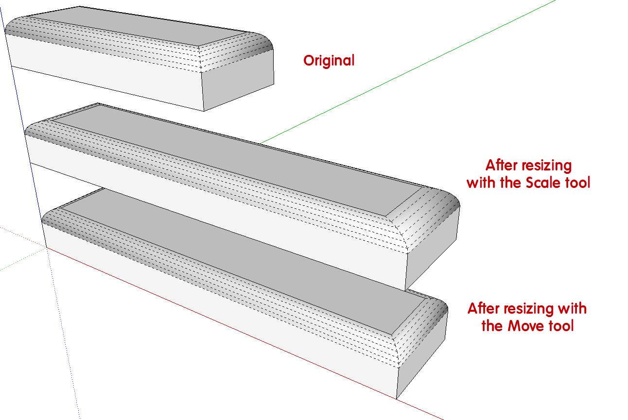

        If you are using the Scale tool, you can type the final dimension followed by mm to get a precise scale change. Keep in mind that the Scale tool may not be the correct tool for changing the size of something. If you are changing the length of an object that has had a round over applied to the edges, scaling will change the shape of the round over, too. In a case like that, the Move tool will be the better choice.
