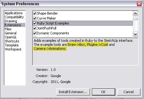

      I was instructed to enable the "Ruby Script Examples" plugin for "point at center access". That worked great. Now I want to know what else came with these Examples. Is there a list of the examples so I can explore the new features this plugin added?

        Open the Script Examples script file (in the Plugins folder) using a text editor and have a look.

          Interestingly, the Preferences dialog lists three other plugins but the point at center.
