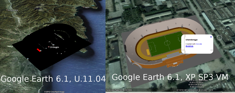

              Info update, seems Linux doesn't like my models πŸ˜† I have just re-scaled my model within the actual photo and tried it in the latest Google Earth versions both in Ubuntu 11.04 and Windows XP SP3. The results are dramatically different: Ubuntu's GE shows a deformed, largely upscaled, black model, and Windows' GE displays the model as it should be. So weird, indeed.
              I'm attaching screenshots and my final model. Thanks for your help πŸ˜‰
              A comparison between versions.
              The properly scaled and placed model.

                  Aerilius
                  Hi stage7,
                  this is neither a problem with Linux, nor with your kmz file. It is a known bug in Google's Collada reader of Google Earth (linux version). I reported it several times, but Google developers haven't touched anything except wiping away the bug report when they thought it was too old.
                  http://code.google.com/p/earth-issues/issues/detail?id=1186
                  I usually get along without previewing models in Google Earth (but rather waiting until it is accepted to the 3D layer), or I use the Windows version of Google Earth in Wine.

                    stage7
                    @Aerilius: thank you very much for pointing out as everything is crystal clear now. I will keep on previewing my models in GE for Windows until they decide to fix the issue 😞
