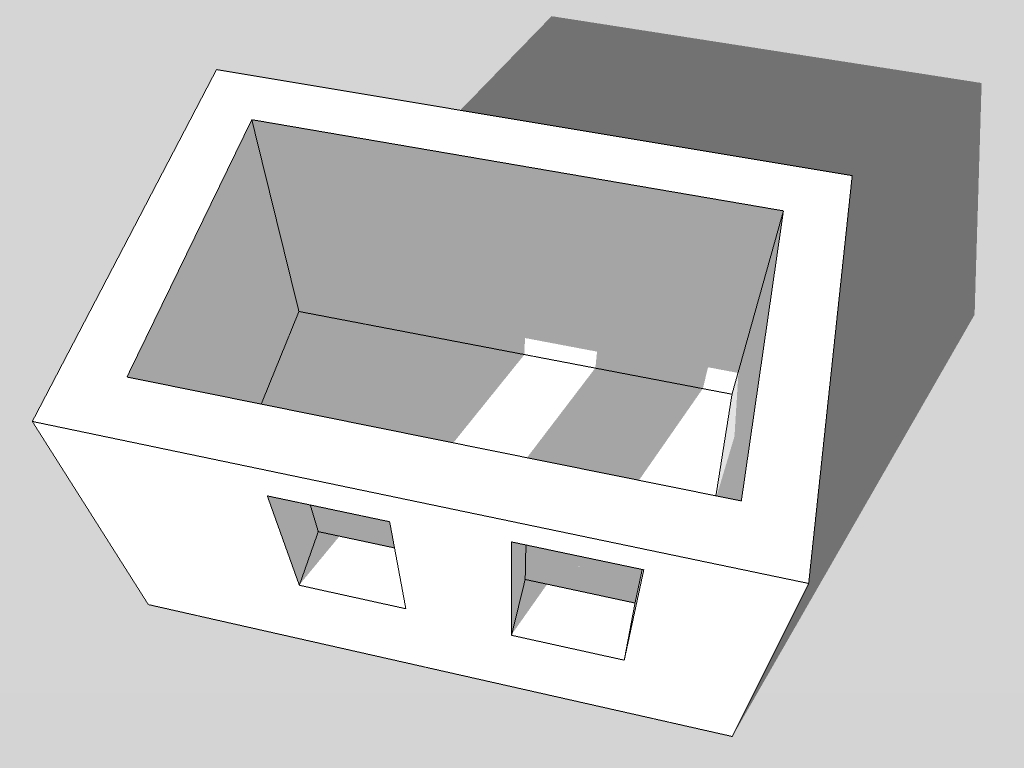

      Hello all
      I am new in sketchup and I wanted to know if I can see the shadows that are inside the house that I created.
      In Ecotect I can cut away section and the shadows do not effect from that.
      Can I do the same in sketch up? Like taking of the roof and see how much sun light I get inside?
      Thank you
      Sagi
      • GaieusG Offline
        Apply a completely transparent pgn material (see one attached in the model below - save the material file for later use) to a ceiling or any section cut face in SketchUp. It will cast a full opaque shadow.
        shadows.skp
        • C Offline
          crisRobin
          Thank you Gaieus, This is what I needed.
