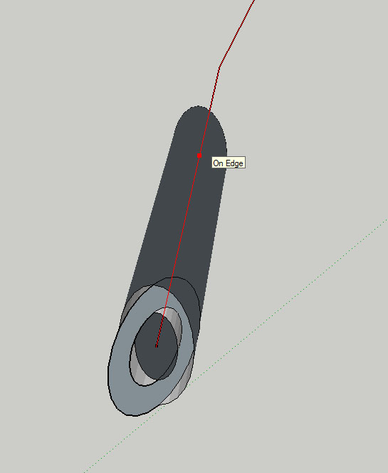

Hello,
I am simply trying to take a circle along an arc to be the "arm" of a lamp fixture. But when I use the follow me tool it warps the circle so that it is not round or flat on the correct side anymore. See attached image. Is there an easy solution for this?
Thanks.
Kirsten, the problem is that your circular profile doesn't start out perpendicular to the first segment of the path so SketchUp projects a perpendicular face which is thus not circular but elliptical. The solution is to place the circle so it is perpendicular to that first segment. then SketchUp won't need to make the projection. Note that the extrusion will finish up perpendicular to the last segment as well.

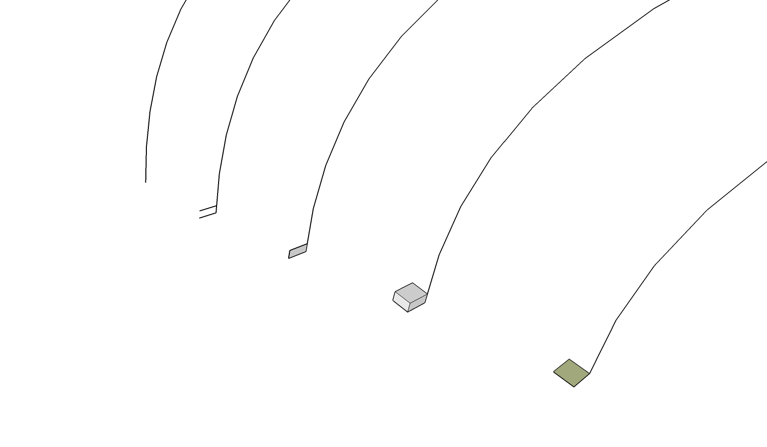

Your question might be, "How do I construct the face perpendicular to the end of the arc. Well here's one way.
Working from the back left:
Your arc.
Draw two lines off the arc and parallel to each other. They are perpendicular to the segment of the arc.
Connect the two lines with another line to create a face.
Use Push/Pull to extrude the face a bit.
Delete all of the resulting box except the face at the end of the arc. That face (shown in green here) will be perpendicular to the first segment in the arc. That's not the reference face for your circular profile. -
